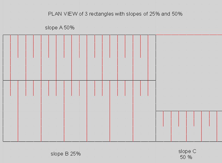

Thanks to both of you for your help. Autocad apparently has a slope hatch tool, but because of copyright warnings I did not copy their example.
Below in the attached JPG I did the best I could to show you my example of three slopes on a plan view.
The slope outline is a rectangle. There does not appear to be a universal standard for showing a slope of a terrain. I managed to find the following:
the hatch pattern consists of multiple vertical lines of different lengths, typically one full length line and one line (or two lines) that is (are)proportional to the slope angle. Perhaps this could be done with an existing pattern like ‘grid’ pattern? I tried but failed. :frowning:

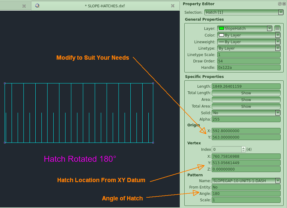

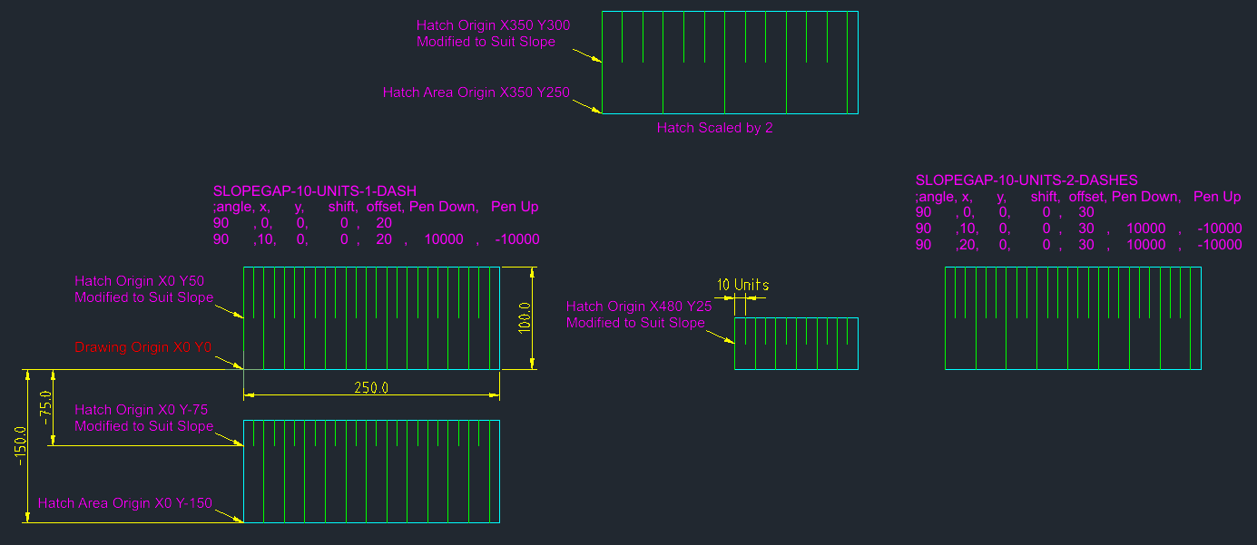

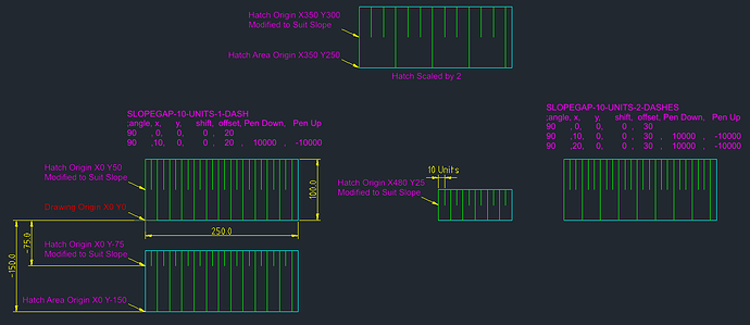

Hi Marc
I’ve tried to keep this as simple and straight forward as possible so a novice user can follow what’s happening.
I’m not sure what drawing units you use so I’ve gone with 10 for the X spaces,this can be scaled to suit your needs and I figured it would be the easiest to work with.. Scale of 0.1 = 1 and Scale of 10 = 100 and so on..
1st and most important thing to understand is Hatch Pattern origins when applied always use the datum X0 Y0 on your drawing, this can be changed to suit your needs by left clicking on the Hatch Pattern and changing its Origin properties.
I’ve Attached a Sample DXF for you to look over, hopefully it makes sense :slight_smile:
I also added a couple of angled rectangles for your reference.. I think with it being a visual representation of a slope ligning the pattern up by eye would suffice… of course you can always calculate this with trigonometry but it would probably be an overkill :slight_smile:
OHHH I Almost forgot you can use the keyboard shortcut IO to find the bottom left coordinates of your rectangle…
Zip File Attached with DXF / Notes / Screenshots & Hatch Patterns
Slope Hatch.zip (152 KB)

Nope it’s intentional the slope is adjusted by the amount you move the hatch pattern..I’m trying my very best to keep this
as simple as possible.. thank you…

I see, meaning the user has to adapt origin to position.
It is a pity that origin isn’t moved when moving entities.
