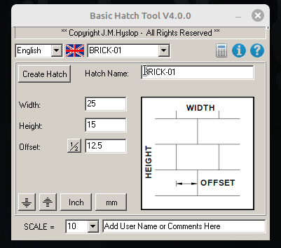

If anyone is interested I have a free standalone Basic Hatch Pattern Tool you can download on link below:
It works on Linux ( WINE ) & Windows 2000 - Windows 10 32 & 64bit ,
It can be used to create hatches for QCAD Community & Pro Versions.

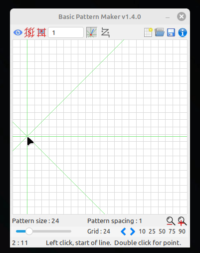

Also try Basic Pattern Maker created by Myself and PeteVick, create your own basic hatch patterns.
Basic Hatch Pattern or Basic Pattern Maker which is Windows and Linux Compatible
Ribbonsoft site <— Basic Hatch Tool
Basic Pattern Maker [ Windows & Linux ] - QCAD Script Programming & Contributions - QCAD Forum <— Basic Pattern Maker

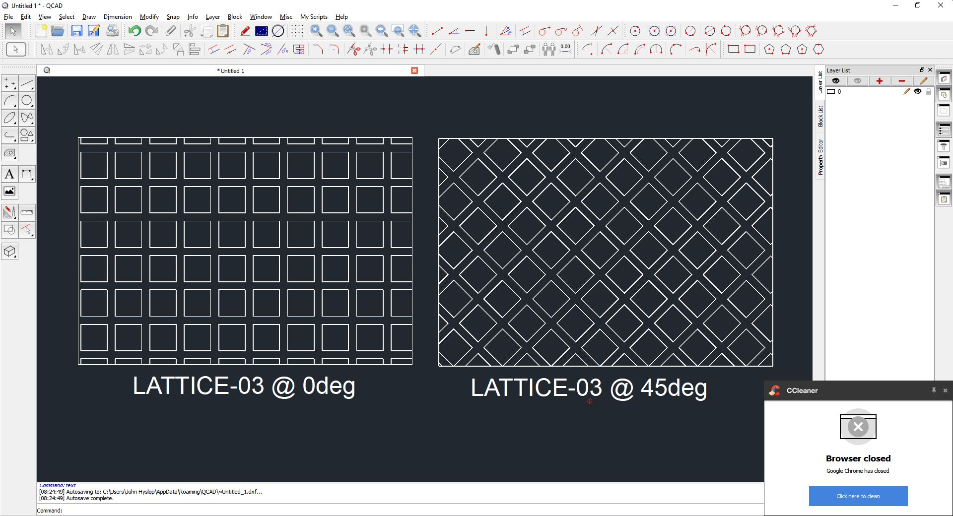

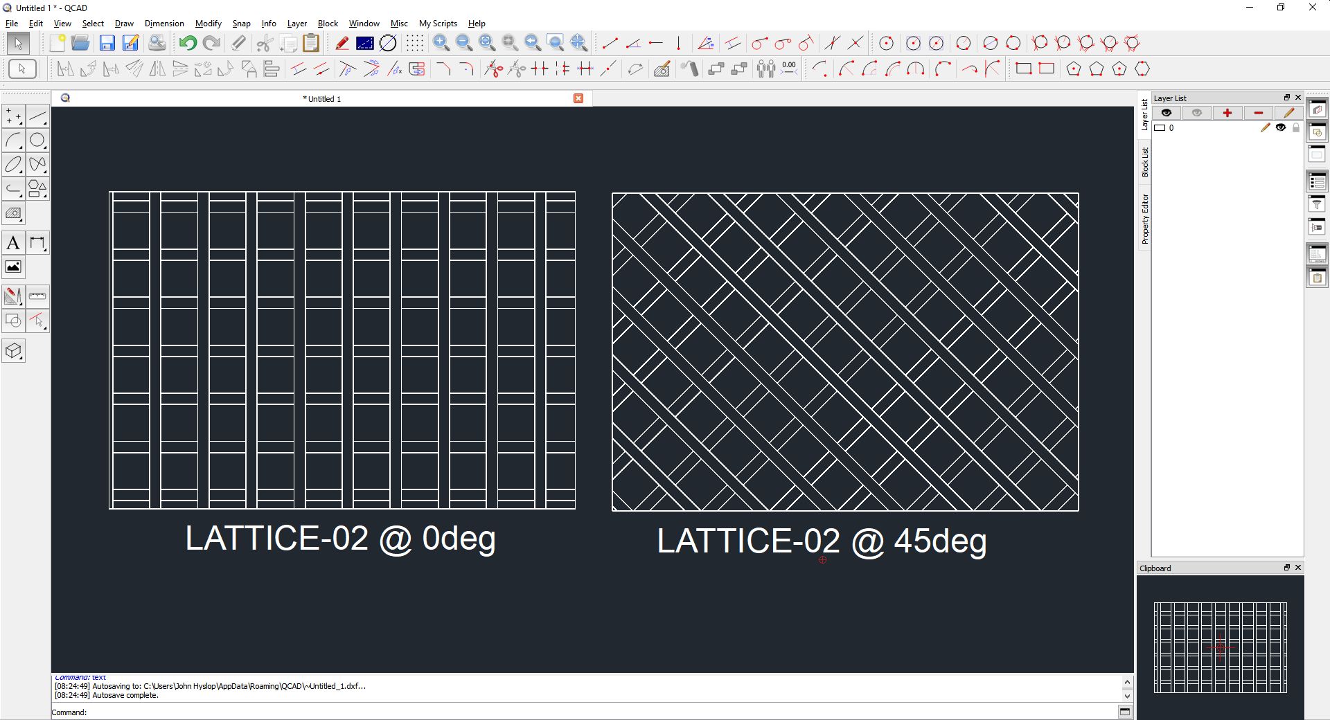

LATTICE-02.pat (327 Bytes)
LATTICE-03.pat (471 Bytes)
LATTICE-04 [ see angle note on screenshot ] to make it orthogonal..
If you require a more accurate angle the true one is 26.565051deg :slight_smile:
LATTICE-04.pat (633 Bytes)

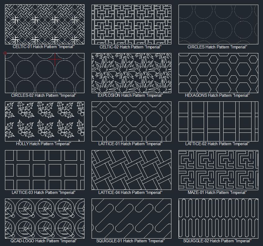

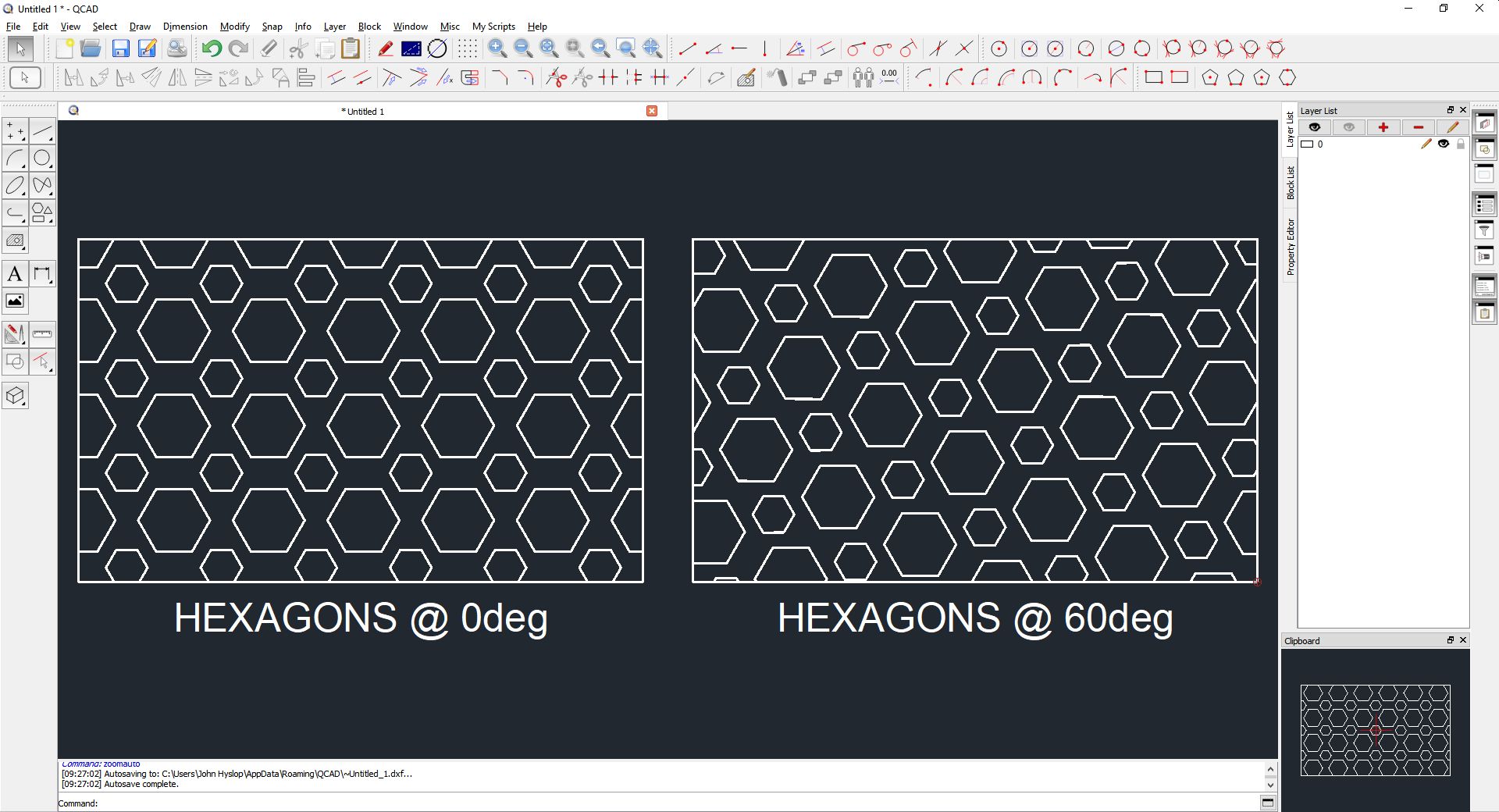

HEXAGONS Pattern
this one is different from installed hex.pat
HEXAGONS.pat (789 Bytes)
[This Pattern Has Been Removed Due to Copyright Concerns]

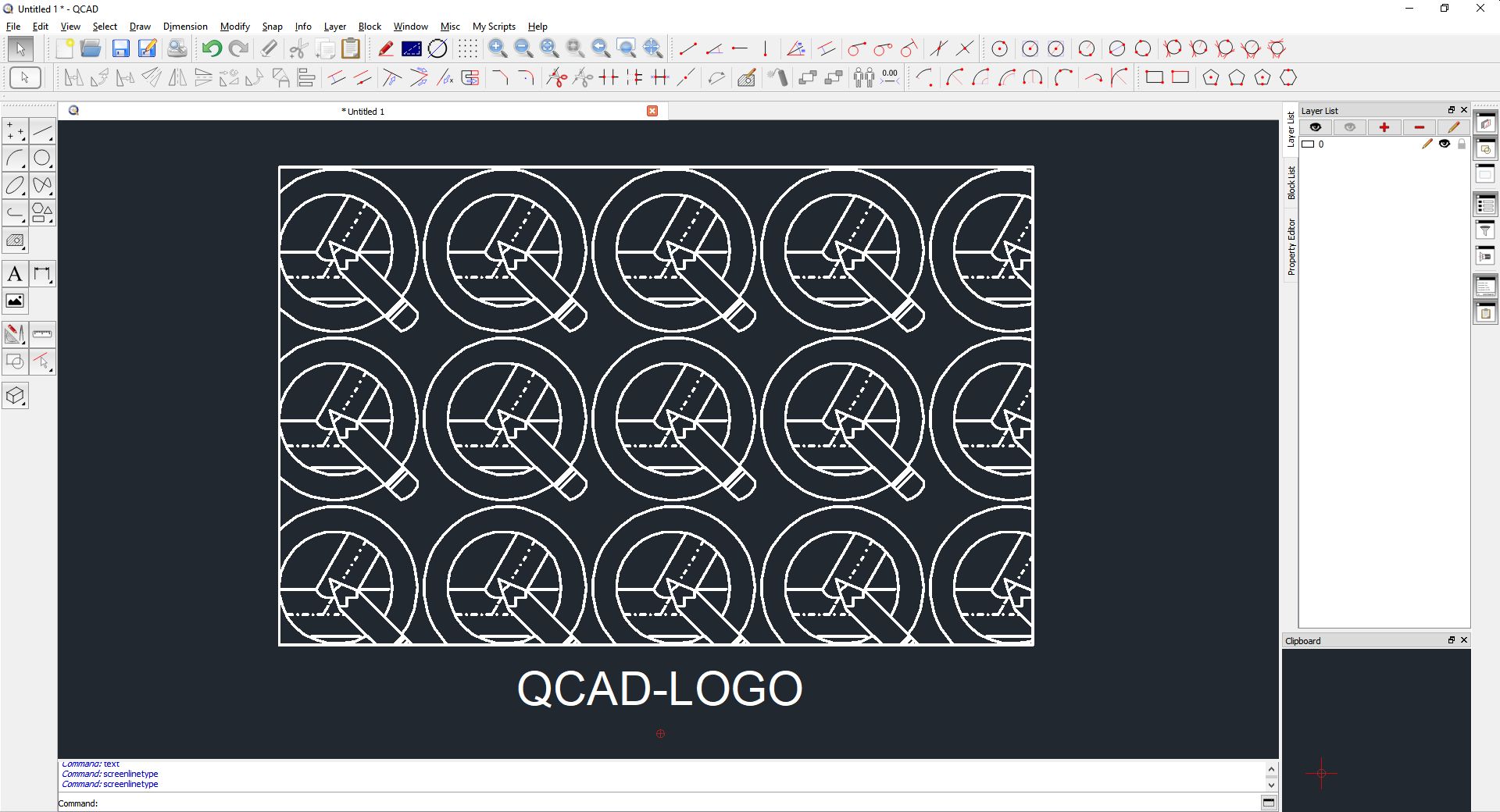

QCAD_LOGO
This one is a bit rough as you cannot use arcs or circles in *.pat files
only points and lines…
New Updated Pattern now on Page 4 of this topic
QCAD-LOGO.pat (6.71 KB)

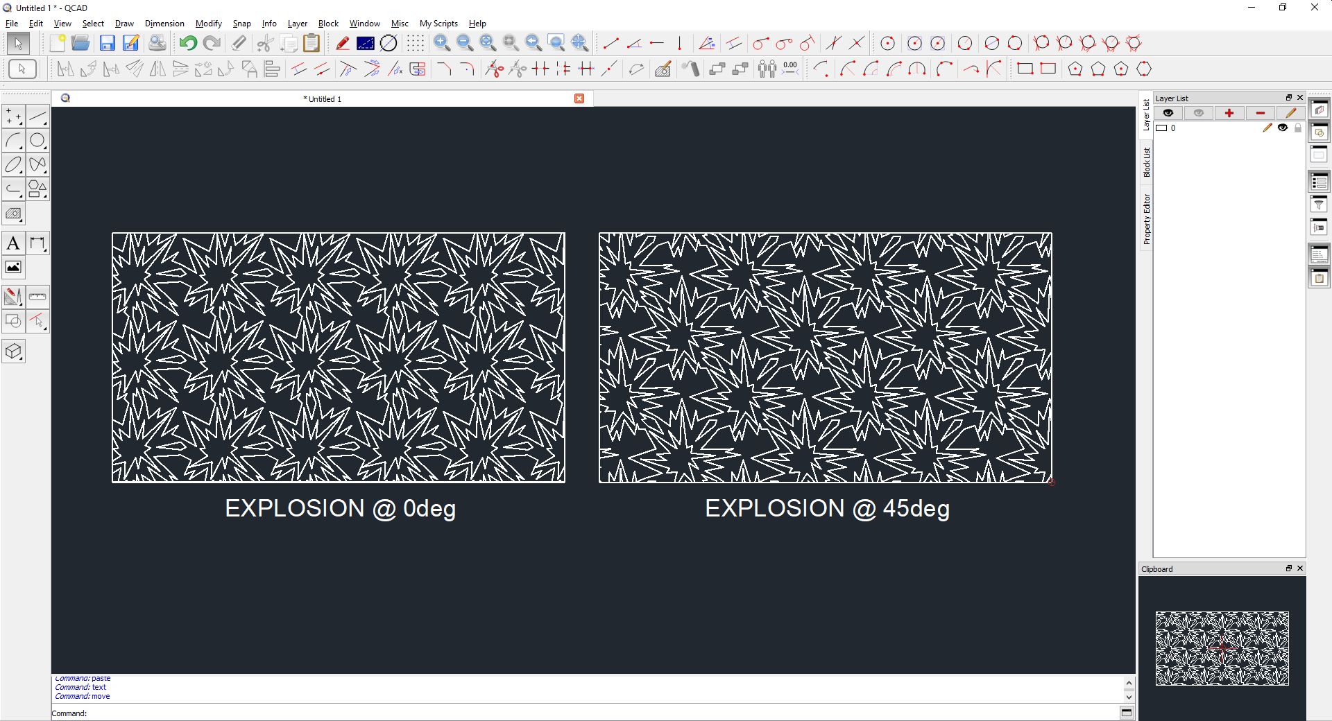

EXPLOSION [ Pattern ]
EXPLOSION.pat (3.91 KB)

QCAD-LOGO consists of 125 lines… :open_mouth:
But thats nothing compared to YUKONRUBBLE.PAT, 4533 lines. e_surprised
Although, Qcad can’t handle that one.

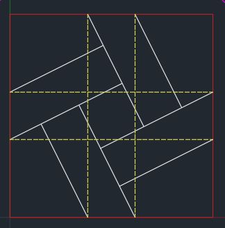

Also elaborating on why I did this this way “at this obscure angle” , have a go at making a seamless version of it orthogonal :slight_smile: it’s impossible…
FYI I’m attaching a screenshot of how I made this pattern the yellow lines I put there to indicate how the pattern becomes seamless as it is
arrayed horizontally and vertically :open_mouth:

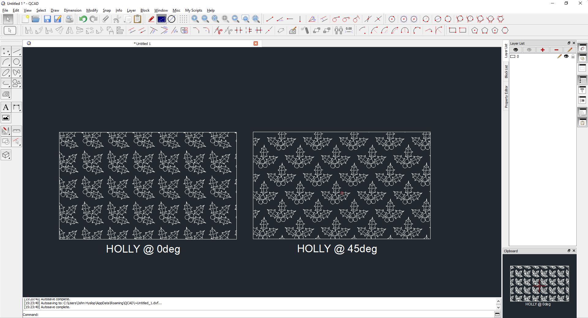

[ HOLLY PATTERN ] Just in time for Christmas :slight_smile:
HOLLY.pat (10.6 KB)

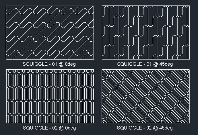

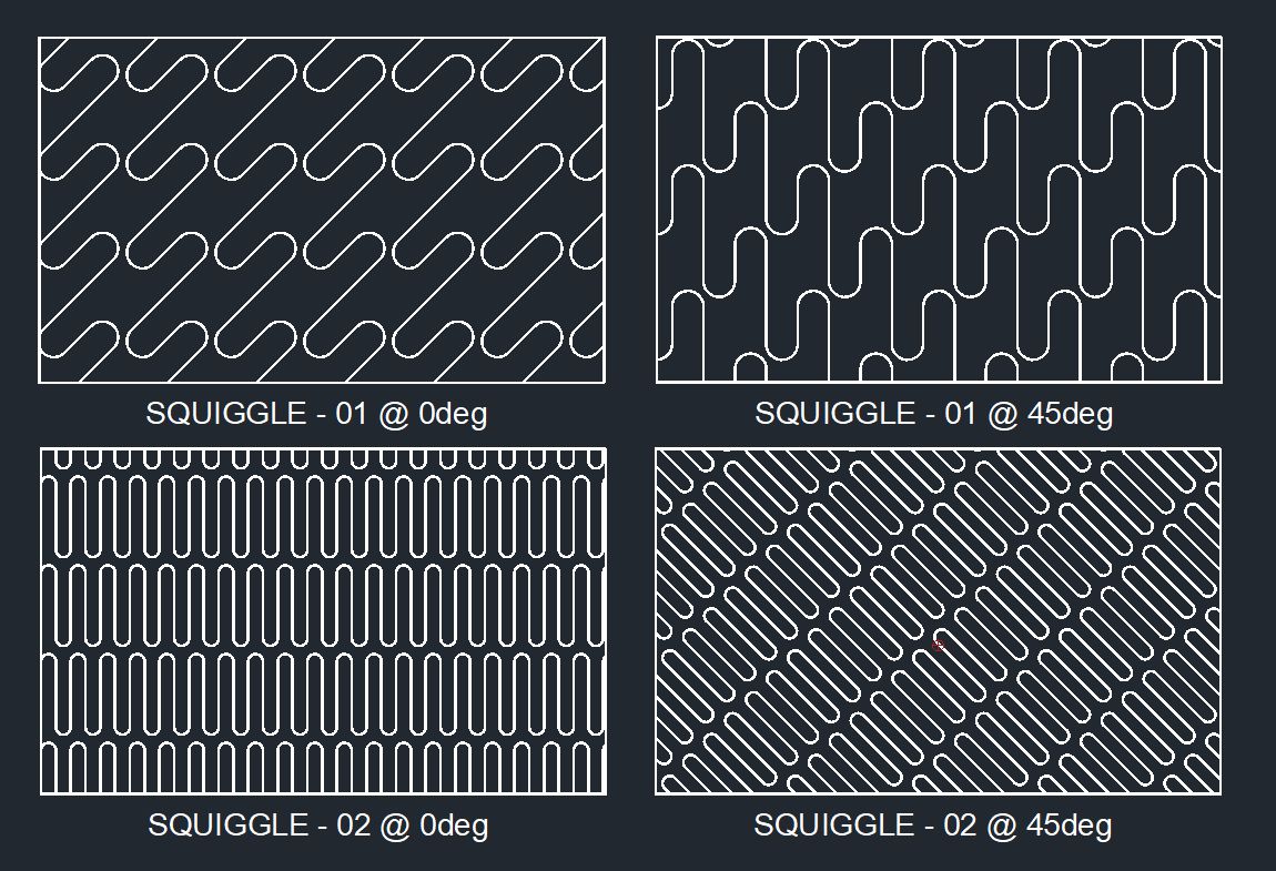

SQUIGGLE - 01 & SQUIGGLE - 02 Hatch Patterns
Can simulate under floor heating coils…cheated massively on this one, but it does the job :laughing:
Can also be used for insulation like the hatch you did..:ok_hand:
New Updated Patterns now on Page 4 of this topic
SQUIGGLE - 02.pat (7.13 KB)
SQUIGGLE - 01.pat (1.67 KB)

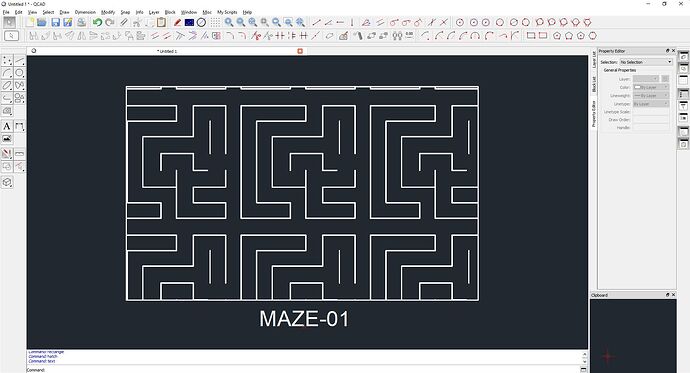

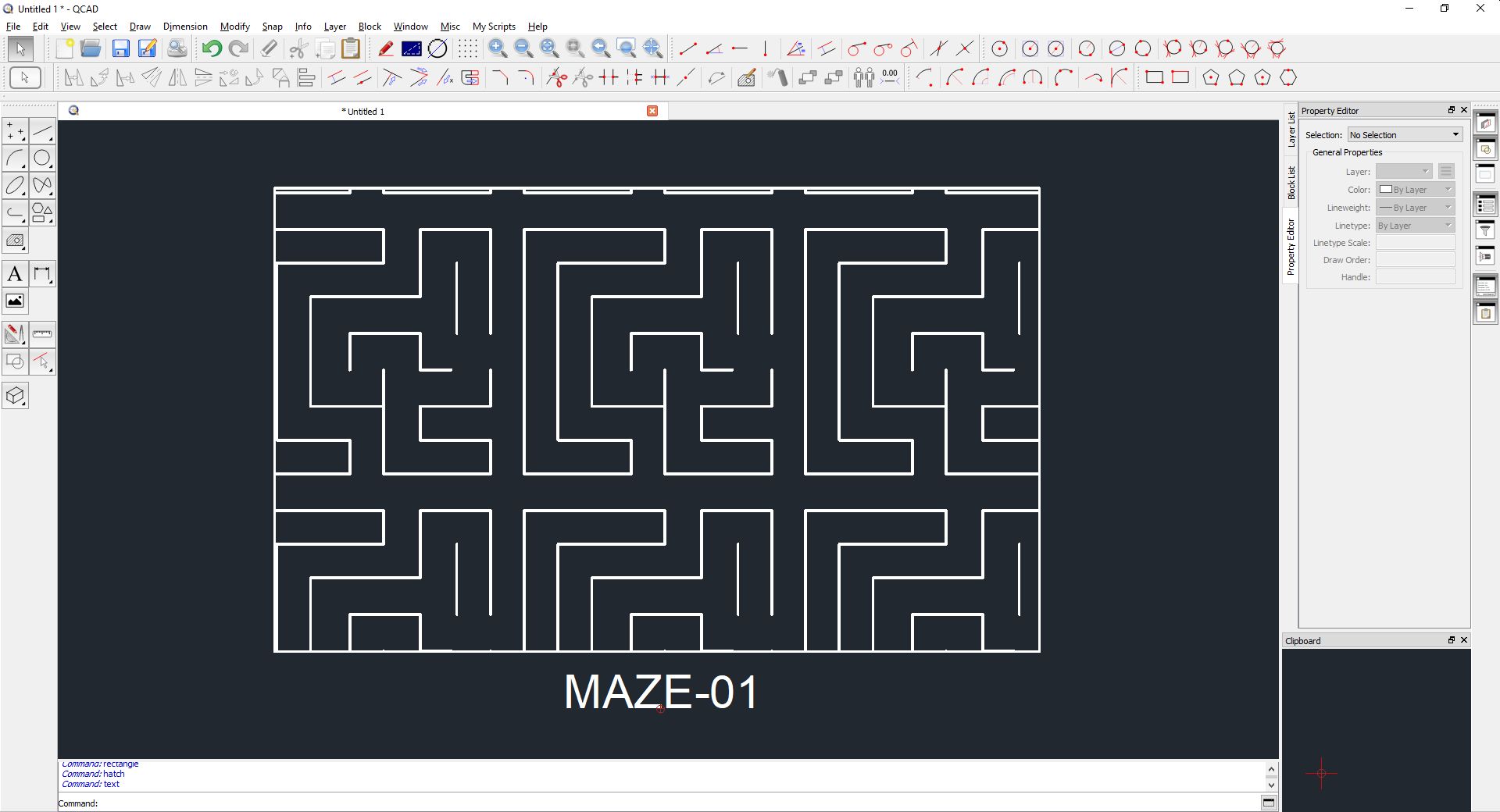

[ MAZE-01 ] Qcad Hatch Pattern
MAZE-01.pat (918 Bytes)

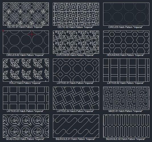

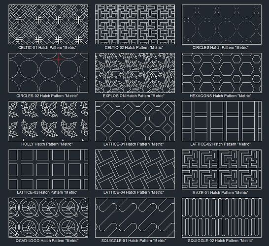

Here is a fullset of all I have done so far if using Metric download the metric set.. Enjoy :slight_smile:
The Dotted Circle Hatches are made with short lines.. not the best practice but ok for representations..
Some Pattern Updates are now on Page 4 of this topic
Set of 15-Hatch-Patterns.zip (13.2 KB)

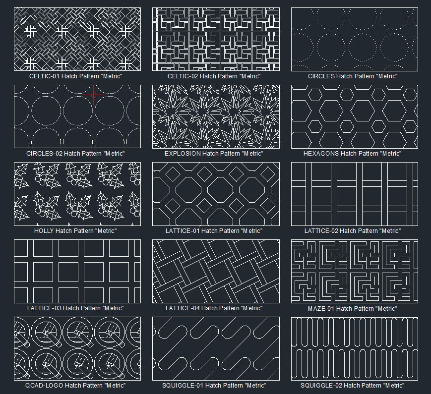

Qcad Metric Hatch Patterns
Some Updated Patterns are now on Page 4 of this topic
Set of 15-Hatch-Patterns [ METRIC ].zip (15.2 KB)

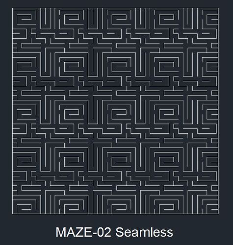

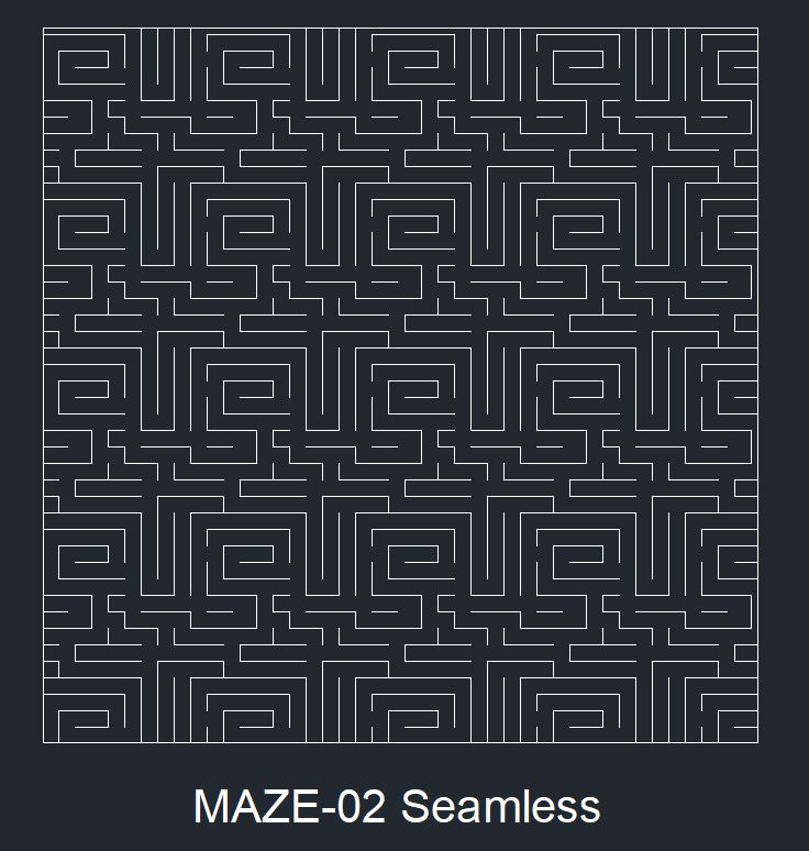

MAZE-02 Seamless in Imperial… Metric File to Follow
MAZE-02.pat (1.24 KB)
