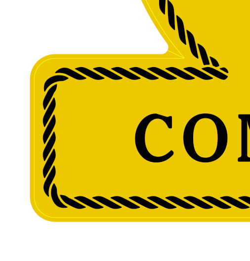

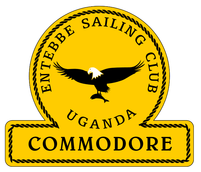

It started with an order of my old mentor in engraving.
He is retired and lives partially in Uganda these days.
The order was to make 14 badges as relation gift.
The first pic is the design I got from him, the second is what I proposed.
I followed a tube on how to flex the rope manually.
Drew 1 corner with Qcad and cloned it 3 times.
The badges are allready donated a while ago.

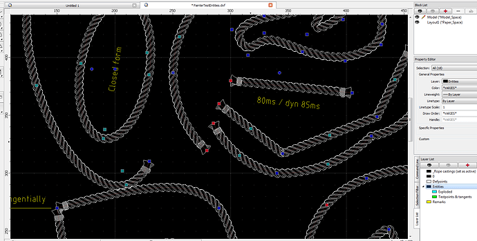

The script adds an entry to Misc| Script Examples | Mathematics | ..
The script mimics a roller stamp that travels along the selected base curve.
Pictures say more then words.

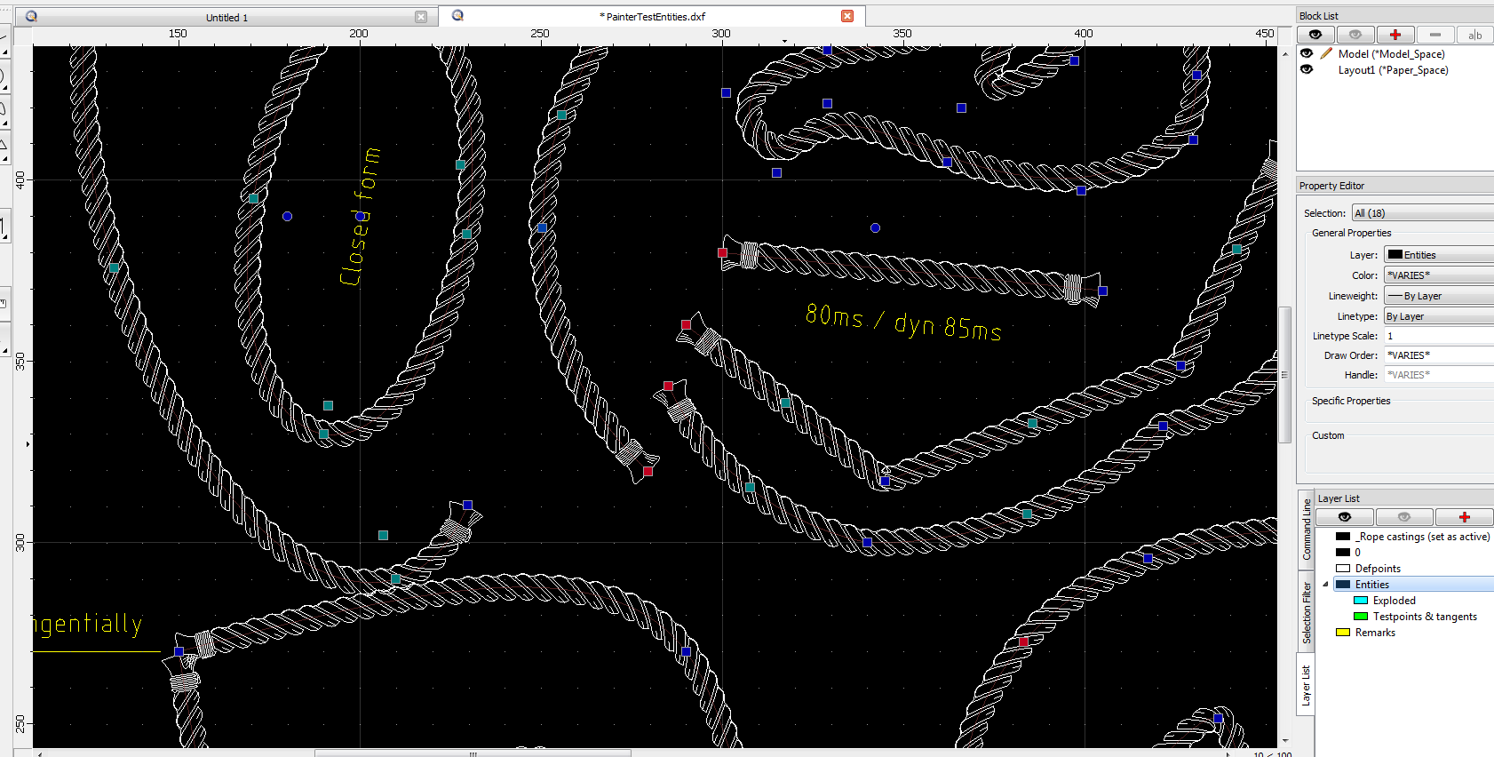

The math was simply cast left , cast right.
But then it evolved in several stages.
All curve-based
Nice endings.
Apexes.
Dynamically scaling to a closed form (without apexes)
The idee of insertions eg. a knot in this case.
Global casts along the base curve.
Margin crossing.
The FlexPainter having the flaws in steep curves is error-like but it is super realistic.
Twisting a roller stamp to much will smudge.

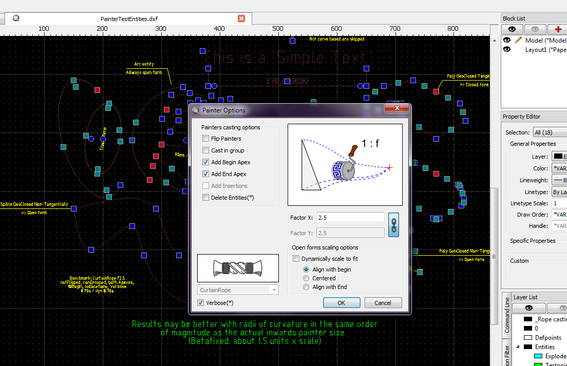

Flexpainter Beta v0.40
point4 is in essence a full rewrite of the casting core envelope.
Painters are base9 in analog of the CXF fonts. :exclamation:
Definition width is changed to 9 units, non-restrictive.
The user can choose width, length and stepsize in actual document units.
Aligning is now properly supported, with sub-chains as well globally as locally.
(What was of no issue for the ‘CurtainRope’ because it is slanted) :astonished:
Solved the issues with painter definitions situated on the margins.
The problems occured at entity endings of splines and polys.
I’ll post a seperate topic on that. :neutral_face:
Added several simple but usefull painter sets besides the ‘CurtainRope’ painter.
These were primarily used for testing.
The sets definitions are still hardcoded in the script file. :neutral_face:

Solved the painter selection issue. :slight_smile:
Don’t ask me how. :confused:
At the moment my insights in this matter is basic to none.
With this fixed the focus is now set on insertions eg. a knot.
:exclamation:
On firts load or on document switch the tool shall
auto adapt to different document units.
There is a story about that this morning, you may want
to read in the note to Andrew.
:exclamation:
Repared the ‘flip painter’ that was broken with the transition to units.
Repared the spinnerbox for 0-100% shifting that was not spinning. :blush:
:exclamation:
Enhanced the painter definitions types:
  • Local: Point, Line, Spline, Arc, Circle, Poly (+bulge!?)
  • Global: Spline, Poly (no bulge yet)
:exclamation:
Painters are base9 in analogue with the CXF fonts.
Definition width is 9 units, non-restrictive.
:exclamation:
Added some more painters sets.
Added all preview icons of these painter sets.
The icons are all in a sub-folder ‘Icons’.
The idea where I am playing with is to split the definitions into files/scripts.
Any ideas or preferences someone? :bulb:

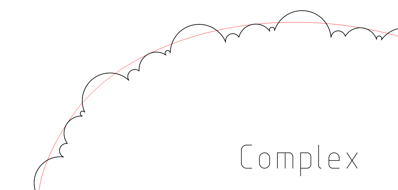

Coded some clouds painters.
Will be included in a next release.
Regards.
RevisionCloudTest.dxf (134 KB)
