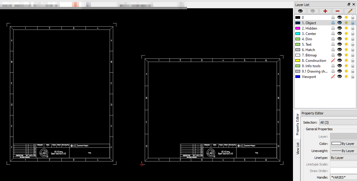

If yes then prepare a drawing with your generally used layers like Object, Hidden, Center, Dim, Text, Hatch blablabla - you get the idea.
Now create in the same drawing an ANSI A Border in your Model_Space (Main drawing canvas at QCAD) for portrait and landscape as you need it. Everything has to be in 1:1 and it will later be printed in 1:1 too. Save this template.
Something like this:

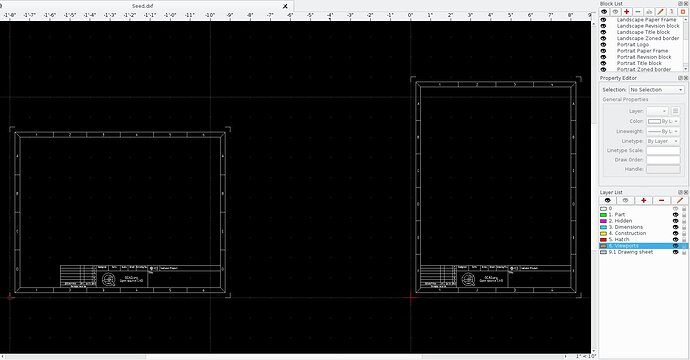

I updated my seed file as you suggested. I’ve included a snapshot of its current state.
To place both borders in the same file I had to rename to blocks or things behaved strangely.
At any rate, I believe I’m ready to move forward.
Bill Lugg

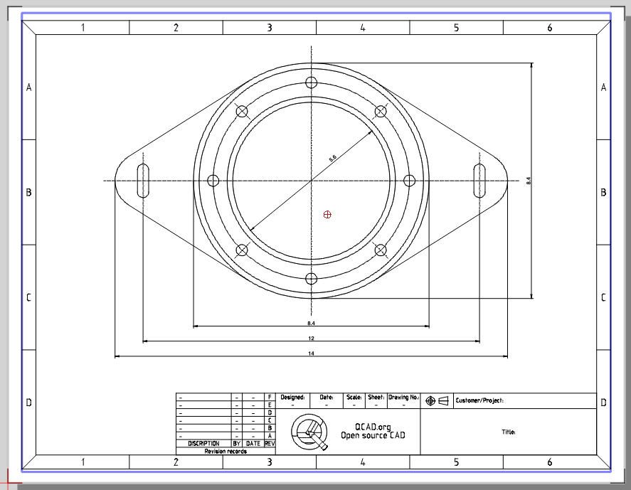

Please download this QCAD example flange and copy it 1:1 into the Model_Space of your new template:
Test flange.dxf (112 KB)
This is an inch drawing and doesn’t fits on an ANSI A sheet. We’ll now create a Viewport, scale it 1/2 and place it for printing into the Landscape Layout Block.
To do so:
Make the Layer Viewport active,
launch the Viewport tool below Menu / Draw / Viewport / Add Viewport
an option bar pops up - chose on the left the scale 1/2
now create in Model_Space the Viewport (drag a box around the flange with the mouse pointer),
a box pops up where you can chose the Layout Block - in this case the ANSI A L is the right one,
QCAD jumps now to the chosen Layout Block and you can place the Viewport as you like it.
Now your part is scaled 1/2, in an already fitting boarder and after filling out the Title Block information ready to print in 1:1
Note: Read the name Viewport to the letter! It’s a “Window” to your actual drawing in the Model_Space. Every change which is done in the Main drawing and is covered by a Viewport will also be changed in the Layout Block.
Play around with the possibility to understand the philosophy behind it. Don’t save the Template together with this flange example - we need an “empty” Template.

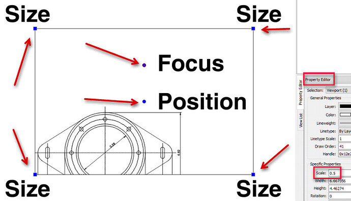

Through some experimentation I discovered I don’t see a way to resize a viewport should modifications to the model wander outside the viewport space. I see handles at the four corners of the viewport in the layout, but clicking or dragging them want to move it instead of resizing it. is there a way to resize one?

Oups - my bad! I forgot that the current QCAD Version has an issue with that feature but I’ve seen that it should be fixed for the next release. Your workaround is the right way to do it!
Yes, in the Layout Block (Paper_Space) you can manipulate the size, position and focus with help of the 6 blue reference points. If you need to change the scale you can do that within the Property Editor.

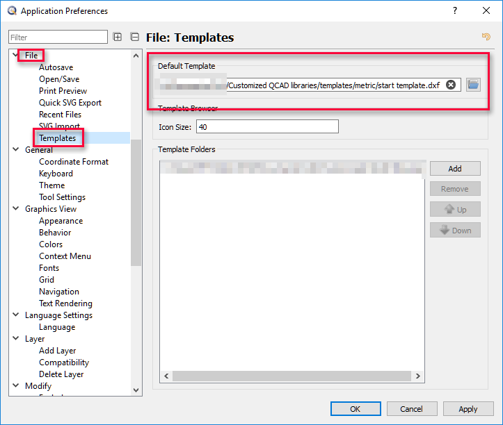

Ok, now your Default Template needs a permanent home :sunglasses:
Save the Default Template at a convenient location on your system. It should be a common directory with all rights to read/ write etc. a file. Don’t save it below the QCAD Installation tree for QCAD update reason.
Now open the QCAD Application Preferences and tell QCAD where to find this template.
Menu / Application Preferences / File / Templates
It should look similar to this entry’s:
After confirming the dialog with OK restart QCAD. If you did everything right QCAD will start with this Default Template which is ONLY a copy of your template and has the typical name “Untitled 1”. This is now a prepared but empty self-contained drawing. What ever you change in this drawing it will not be reflected in the Default Template. Save it as usual with a new file name. If you start a “New” drawing in your session = same story. :wink:
If you need to change the Default Template open it directly - change it and save it back at the same location.
I think you are now ready to rock. You’re? :smiley:
Yes, I was able to resize the viewport, fiddle with the scale and have made my seed file my default template.
