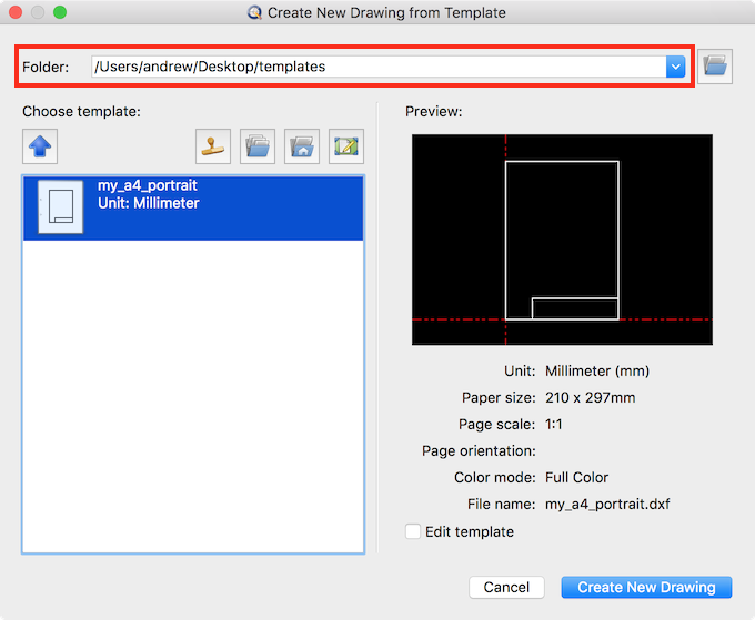

- Choose File > New from Template…
- Choose a template and click “Create New Drawing”

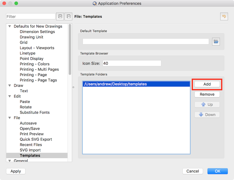

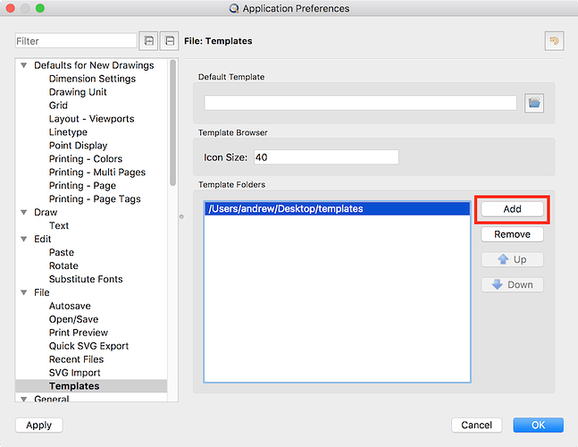

- Create a directory for your templates somewhere in your home folder, desktop, etc. For this example, we create a templates folder under /Users/andrew/Desktop/templates
- Add that folder to the templates folders of QCAD under Edit > Application Preferences > File > Templates > Template Folders
Save your template drawings into that folder or a subfolder of it. Template drawings are regular DXF or DWG drawing files which contain your border, list of preferred layers, blocks, layout blocks, etc.

Your templates are now ready for use. If you create a new drawing from a template using File > New from Template, you can choose your configured folder at the top, browse your templates and create new drawings from them.
