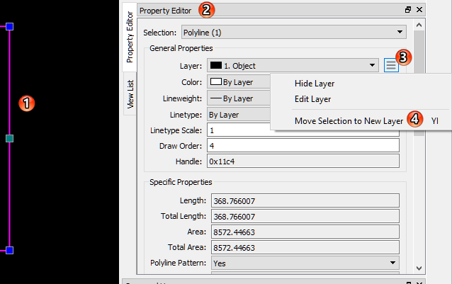

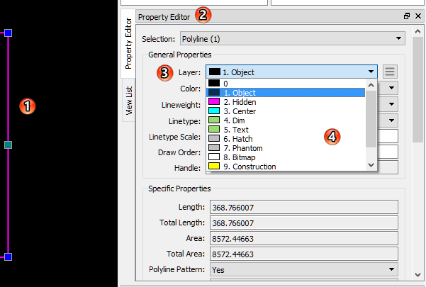

Yes. Select the entities and use the Property Manager to move to a different existing layer …
… or create a new layer.
