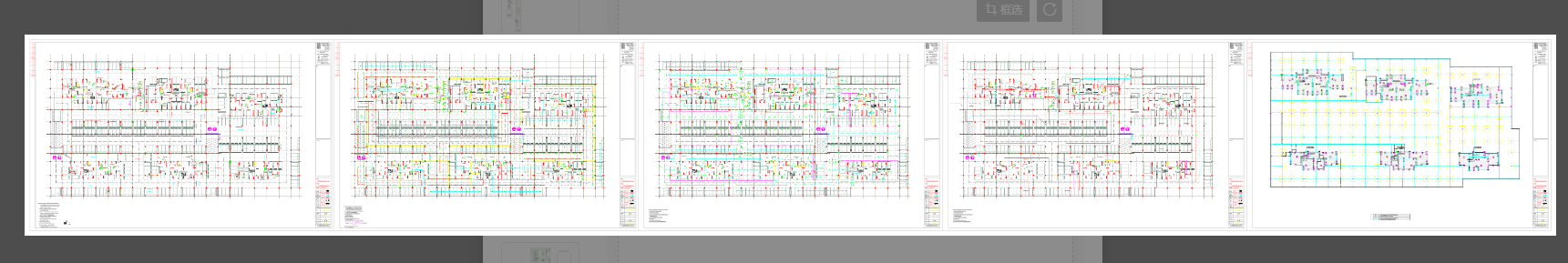

Whether command line supports identifying and exporting different layers?
Problem:Whether command line supports identifying and exporting different layers?
Current command: ./dwg2bmp -platform offscreen -zoom-all -width=6000 -height=6000 -flat -f A.dwg
How can I use command line to complete the conversion?
Expected output: Export different BMP/PNG files for each layer.
Environment
Linux Centos7
Qcad 3.23.3
A.dwg (7.66 MB)

Your ‘Expected output’ displays all 5 pages.
If it is the intention to include them all in one bitmap then remind that the bitmap size is limited to 2’147’483’647 bytes.
In color requires 4 bytes per pixel or about 537Mpx.
Your instruction line does not include how many pixels per drawing unit, presumed to default to 1px/unit.

Because I am unable to open your drawing over here …
Could you attach a screen capture of how your file is displayed in the QCAD GUI.
When failing QCAD does not add the file to the files to open on startup.
