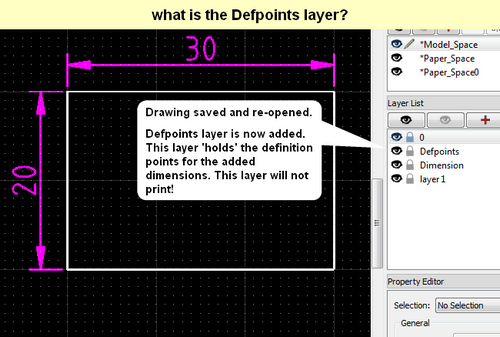

The Defpoints layer is a standard system layer used by AutoCAD and other CAD programs and is part of the DXF/DWG format.

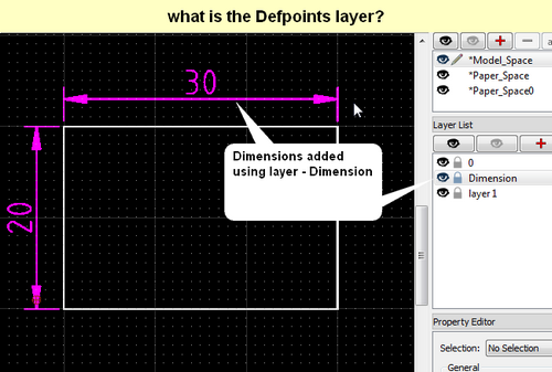

In QCAD, the layer ‘Defpoints’ is automatically created when you create a Dimension entity, this layer holds the “definition points” for the dimension.
Definition points are reference points for dimensions - they are point entities that are drawn and are associated with each dimension added.
Because these reference points serve no particular purpose on a ‘print out’ - layer Defpoints will not print. This layer is nothing to worry about and even if you delete this layer it will be there again when you re-open your drawing!
