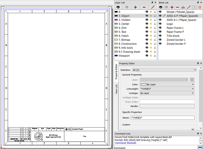

Template: Here is my solution. I prepared a Template with likely used Layer and Blocks. Regarding my printing hardware I can only print ANSI A what means I prepared Layout Blocks (Paper_Space) for the only possible situations - Portrait or Landscape oriented.
When I’m done with my drawing I’ll decide which Print Layout I need to use (Portrait or Landscape) and create the Viewports in that particular Layout Block / Paper_Space.
Now you are free to keep the “unused” Layout Block or just delete it. If you decide to delete it then you can launch the “Purge Unused Blocks” too - all unused blocks are gone …

Maybe it is a good idea to make the “Command Line” visible to see warnings. In this case it would show you a Message what says:
“Cannot copy model space block or layout blocks”
To reuse Layout Blocks a template drawing is currently the way to go.
