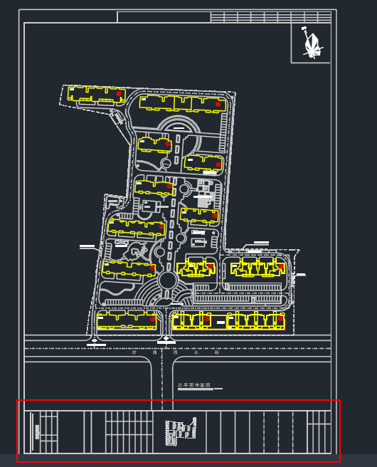

I have another issues: some lines in the DWG file are not rendered when converted to PDF using DWG2PDF. What could be the reason for this?
How can I resolve this issue

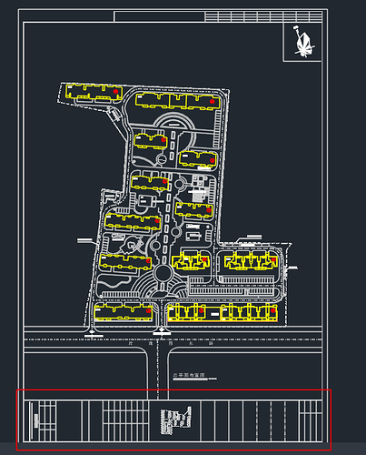

1.pdf (812 KB)

You probably refer to those in the red rectangle …
… Otherwise please post some handles of the missing lines in the PDF.
In the red rectangle we discover a Block Reference based on Block ‘A$C0F44124B
I can not select that with the cursor, highlighted I can double click it what edits the intended block.
Back in Model_Space the Selection Filter can not select it but TA selects everything.
My block label tool tells me it has handle 0x16db … TH won’t select anything but reports that object 3360 is selected.
We can select all (TA), subtract the mystery Block Reference on referenced Block name with the Selection Filter.
After inverting the selection (TI) no selection remains …

I can confirm that the reference to this anonymous block is not loaded for unknown reasons. I’ve created a bug report at:
The above and probably the missing lines in the export are related to hidden layers.
The content of Block ‘A$C0F44124B’ are 94 entities on layer ‘PUB_TITLE’ itself not hidden.
The Block Reference entity ‘0x16db’ lives on layer ‘PUB_DIM’ what is hidden.
Still, the Block Reference is visible in Model_View and in Print Preview mode.
Also highlighted when pointing near it but NOT selectable with the cursor by clicking or with a box selection, selectable by TA.
I was convinced that the Block entity layers AND the Block Reference layer had to visible so that content was visible …
