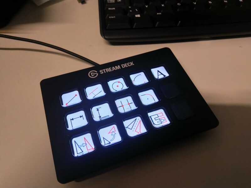

I like making my life easy, so some time back I thought why not use my Stream Deck for QCAD. As said I did not want to lose much time and making all these Icons… well I left it until I found a quick solution.
Make a list of functions you like to use, open the Stream Deck editor. Make a new Profile and link it with Qcad. Open the homepage of Qcad and then go to the QCAD User Reference Manual. Open the page describing the function you want to have on a button. In the Stream Deck editor, drag “TEXT” to the button you want the function on and then just click on the button in the QCAD Manual and drag it to the button, you will see it instantly on your Stream Deck. Now all you need to do is to put the shortcut in the text field. Continue until you have what you need. That’s all, and it’s very time saving when drawing. Have fun.

I did the same thing a few months ago, but I love the two-key commands built into QCAD so much that I find myself forgetting about the Stream Deck. But it certainly is a cool application for this device outside of its primary purpose to manage video streaming. Good Luck!
