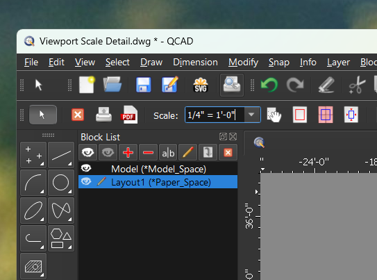

Hi, I am having issues with viewport scaling. I updated the software to the current version Pro 3.28.1. I am on Windows 11 Home. Before the update I was using 3.27.1.

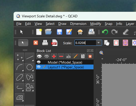

The issue is when I set the viewport scale on the option bar to 1/4"=1’-0" scale it changes to decimals after a while (see screen shots). I would prefer it to stay at 1/4"=1’-0". The dimension settings in the drawing preferences are set to architectural. I have tried fractional with the same results. Why is the scale showing decimals? This is not what I need to quickly tell the scale of the drawing. There must be a new setting as this did not happen with the previous version, but I am unable to find it.

I think that you refer to the Drawing Scale, aka the paper scale, in your images.
The viewport ‘Scale’ and Viewport ‘Rotation’ options are displayed on the Options Toolbar prior to defining the Viewport area.
On placement in paper preview mode these 2 tool options are displayed later than the Drawing Preferences button.
Both displayed scale factors are called ‘Scale’ but the tooltips are different.

Most input field in QCAD can do all kinds of calculations, from simple arithmetic to full blown mathematical equations.
1/4"=1’-0" is simply an equation and the resulting scale factor is 0.0208(333…).
Indeed, the textual notation may stick a while but at some point it will be renewed and replaced by the stored scale factor.

Hi RMK-Designs,
I’m confused by this description and how the drawing is set up - maybe we can sort it out together …
Your example drawing contains 2 Viewports in 1"=1" and 4"=1",
The paper scale is 1/4"=1’-0" what is equal to 0.0208 or ~1:48,
You are talking about viewport scales but the screenshots and the mentioned decimal number are according to the chosen paper scale …
May I ask you why you scale down the paper and then scale up the viewport to compensate that? Why making it more complicated than it has to be …?
When dealing with viewports for printing common praxis (and much easier to handle!) would be to keep the paper scale always in 1" = 1" (1:1) and then scale only those viewports.

A Viewport scale of 1/4"=1’-0" is exactly 1:48 and exactly 0.0208333… and that is an endless repetitive value.
I even think that it is handled in mm and then it is 0.25*25.4/304.8 what is exactly the same.
In the Option Toolbar this is displayed rounded to 4 decimal positions as ‘0.0208’ but it is stored in full floating point notation.
How it is displayed in the Property Editor may vary according the precision preference.
See: Application Preferences .. Widgets .. Property Editor
e.g. as ‘0.02083333’ when maxed out to 8 digits.

Thank you CVH and Husky for all your help. I am embarrassed to say that I have been doing this for many years completely wrong. I thought I was scaling the viewport but instead was scaling the paper. As I now know it is a much more difficult process. Which by the way was the only thing I was not completely happy with in this software. Turns out it was me screwing this up! Thank you for educating me.
I had seen a post by Husky (https://ribbonsoft.com/rsforum/viewtopic.php?t=7028) that showed 2 scales and was told to use the viewport scale not paper scale (screen shot attached). Both scales are no longer available in the print preview tool bar, so I thought currently it is the viewport scale. Turns out the scale for the viewport is in the viewport tool bar tooltip, same as every other tool, which I did not think to look at. If I had it would be much easier to set viewports, dimensions, and text, which I have had to scale to make them look right.
