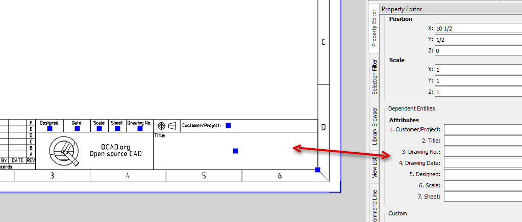

In the question “How do I place multiple attributes in a title block” question, I see a picture of a title block.
Is this title block standard with QCAD, or did someone make it?

Yes and yes, Andrew probably.
In the File menu hit ‘New From Template’ (Ctrl+Shift+N).
Select folder ‘…/QCAD/libraries/templates/imperial’ where ‘…’ is your installation folder.
Select template ‘ANSI A Landscape’ in inch.
Hit ‘Create new Drawing’ in the dialog.
Unfortunately, this standard example template is not using Block Attributes. :confused:
There may be numerous other examples on the QCAD site or in the forum. :wink:
Anything in the public domain is free to use unless otherwise noticed. :wink:

Yes and no. The title block itself comes with QCAD but with attributes it is only available below:
