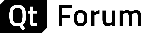

New Ubuntu install (details below), can’t get QCAD to run. Well, it runs the setup wizzard if there’s no config file, and the splash screen looks right. But when the main application window opens, it’s black. It does respond to motion if the mouse travels over it. Also, the Properties window shows up in a separate window. Here’s the terminal output at startup
