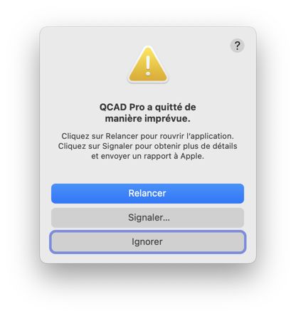

On Apple Silicon M1 Pro, QCAD crashes almost systematically when it is not used for a few minutes.
The exact time before it crashes is very variable, it can be a minute or an hour.
It can crash when it is in the background and not being used at all, but more often it crashes when I bring it back to the foreground.
I could not make a connection to any particular event that could be the cause of the crashes.

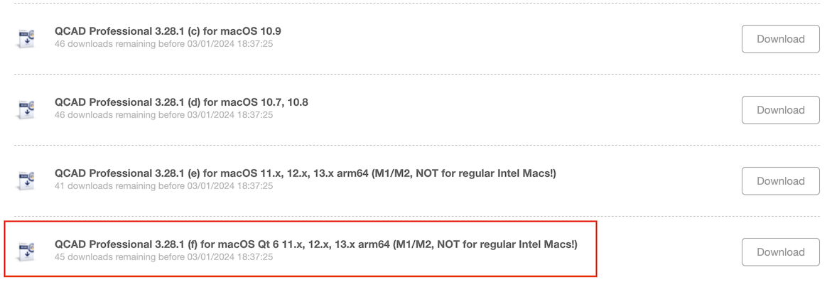

If you experience crashes on M1, please open your download link and download the package:
“QCAD Professional 3.28.1 (f) for macOS Qt 6 11.x, 12.x, 13.x arm64 (M1/M2, NOT for regular Intel Macs!)”
Note the “Qt 6” part in the package name.
This package uses a newer Qt version (Qt 6) which should hopefully fix these issue. Please report back if you experience any problems with this package.

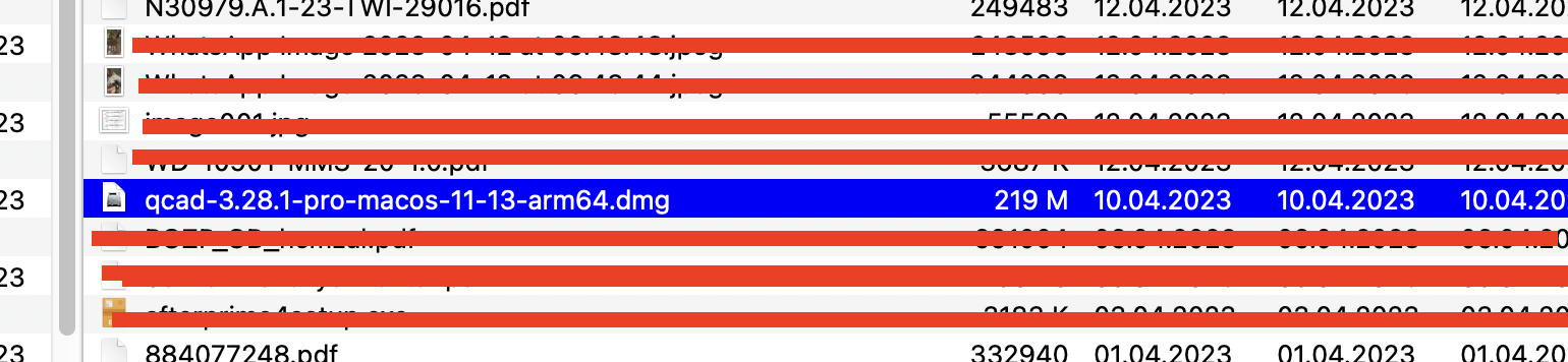

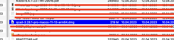

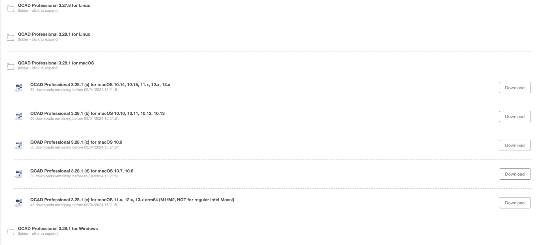

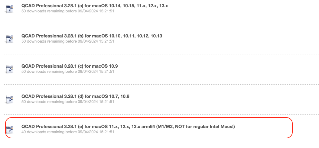

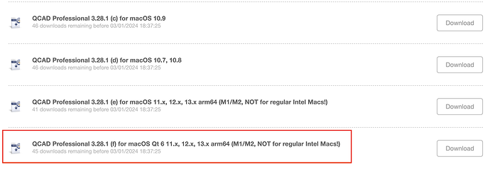

I downloaded correct version - mayby wrong ling on web?
From this page:
I get this file
Milan
There is an alternative package for M1. Note the “Qt 6” part in the package name.
QT6 (f) - not for download ?
that all what i see
That’s an error on our end, my apologies. Please reload the page and try again.
Super,
apple M2 - work without problem.
