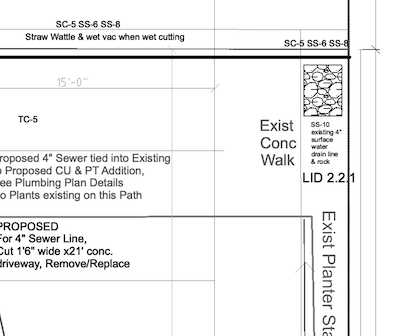

Screen-based linetypes on (this is not how it will print):

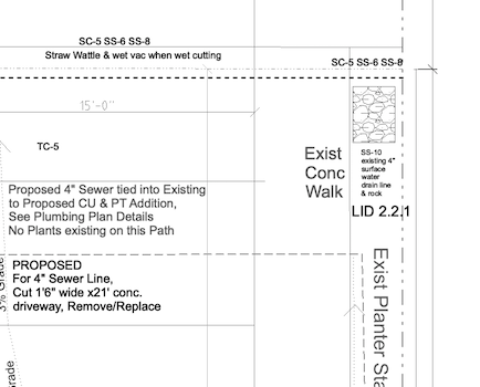

Screen-based linetypes off (this is how it will print):
With screen-based linetypes off, you can now see that your linetype scale is too small. Dashed lines won’t show up as dashed but appear continuous.

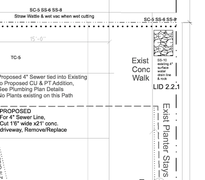

Not the print preview shows the dashes, even if screen-based linetypes are off:
