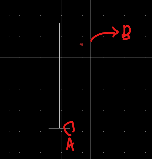

I’m drawing patterns for leathercraft using QCAD.
In this picture, I’m curious about how to draw a line.
Starting from point A, I need to draw a line that measures 8 cm and ends exactly on line B.
How can I draw this so that it doesn’t go off line B and finishes precisely at the 8 cm point on line B?
I’d appreciate your help.
Thank you.

Oh.. I’m so sorry.
I attached the image.
Thank you.
Solved by compass and straight-edge.
First draw an auxiliary circle with an 8 cm (See lower) radius centered at point A:
  • Activate Circle tool ‘Center Radius’ (CR).
    In the Option Toolbar: Radius = 8; Angle = 0 (Doesn’t matter); Reference Point = Middle.
    Place the Circle with its center on point A.
    Let the cursor snap to the rightmost endpoint of the horizontal segment.
    Followed by a right click = ‘Cancel tool’ when done.
The Circle is the locus of all points at a distance of 8 drawing units from point A.
This Circle may not cross Line B, touch Line B at a single point or intersect with Line B at 2 points.
With intersections, one of the intersections is the required endpoint of a line 8 drawing units long starting in A.
Then draw the required line segment:
  • Activate Line tool ‘Line form 2 points’ (LI).
    In the Option Toolbar: Line Segment (Not an Infinite Line or a Ray); Length = cleared; Angle = cleared and both values don’t matter.
    Indicate the start point A.
    Indicate an intersection of the auxiliary circle and Line B.
    Let the cursor snap to the intersection.
    Followed by a right click = ‘Done adding segments’ and a second right click = ‘Cancel tool’ when done.
Select and delete the auxiliary circle afterwards.
Remind that CAD values are typically unit-less.
8 cm is a radius of 8 drawing units long on a drawing in centimeters.
8 cm is a radius of 80 drawing units long on a drawing in millimeters.
And so on.
If you select only the newly created line segment, it should be 8, 80, … drawing units long. :wink:
See Property Editor when selected.

Oh.. Thank you so much..!!
It’s a very simple method, but it’s not easy to approach my thoughts. I solved it!
It is in fact one of the mathematical solutions from solving a system of a quadratic function (Circle) and a linear function (Line).
Again a quadratic equation with: no, one or two real roots (Intersections) in X or Y.
Inserting the real root(s) back into one of the functions solves for the associated Y or X coordinate of an intersection.
But many planar mathematical problems can be solved by simply drawing them. :wink:
