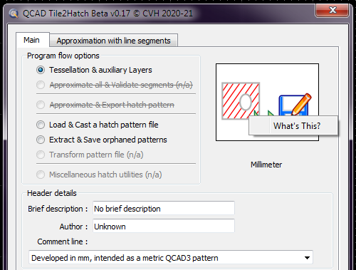

whatsThis doesn’t play well with the QCAD Dark Mode (White on white).
It is untested if that is custom handled in themes by Pete Vickerstaff (petevick) or his QCAD Theme Designer.

For me whatsThis is functional in the Default QCAD theme using the right mouse button and then opt for “What’s This?”.

If any, the whatsThis text pops up after a right click and opting for What’s This in the context menu.

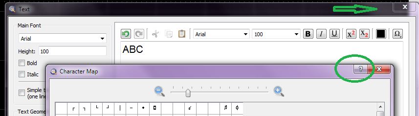

Also notice that we don’t have the [Arrow+?] or [?] button by default as in your case.
And not only for me, have a look at the screen capture by users TrevorW or artisanicview as example.
That has probably to do with your custom compilation of the QCAD source code or the Qt version (5.13.2).

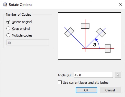

Do all the QCAD dialogs have this button?
Could you attach a capture of for example the Rotate Option dialog?

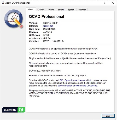

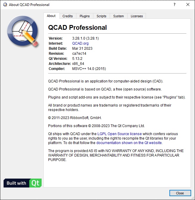

Sure, see attached screenshots. Note that these screenshots are taken from QCAD Pro and not from my compiled version. The ? button is not shown on the rotate options but it is shown on the About dialog. Maybe it’s a Windows thing?
The story is not complete.
I now see the [?] button too on the about dialog.
In About.js we can detect that this dialog is created with:
var dialog = this.createWidget("AboutDialog.ui");

Also detected other dialogs that are created as widget.
e.g. CharacterMapDialog
