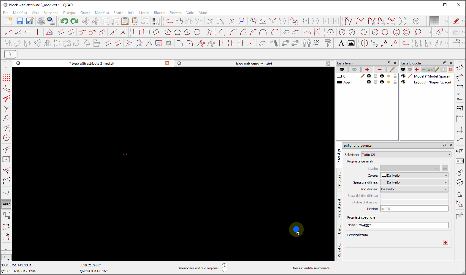

Giuliano,
Please unhide the Block List …
View .. Block List (GB) or just type the shortcut key sequence ‘GB’.
After you have created a block from the selection that block will be listed in the Block List.
Now first edit the newly added block before you add an Attribute Definition.
Select it in the Block List (single left click) and edit it (BE) or double click it.
After that you need to return to the main drawing (EM) or double click on the Model_Space block.
Then the block with attributes should pop up when you insert the block (BI) in Model_Space.

Because it is common to add Attribute Definitions as entities while editing the related Block.
So that Block Attributes are created on inserting the block.
With ‘Create Block from Selection (BC)’:
All selected entities are moved to a block of choice but only a Block Reference of that block is generated in Model Space to replace them.
If the moved entities where Attribute Definitions they are not replaced by Block Attributes in Model Space.
The work around is then: BC .. Delete the remaining selection .. Select the new block in the Block List .. Insert Block (BI)
The relative zero would still be the original insertion point.
EDIT: Hide the block in the Block List before inserting it.
One gets a transaction failure for the Block Reference but the Attributes are created as orphans.
