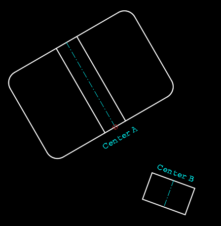

I would like to do something simple but I can’t find how. :confused:
I would like to align the centers of two objects by moving them. I would like the snap to align centers automatically or know the most efficient way to do it. With the mouse, it’s very simple for aligne two end point, but two center …
In my example, I am in state 1 and I would like to get to state 2.
However for the example I used a free displacement which is totally imprecise. I’ll need perfect alignment.

select all that belong to center B
Menu | Modify | Move/Copy (MV)
Tick Source: Select a center snap (or intersection) at B
Tick Target: Select a center snap (or intersection) at A
Choose to delete original, hit OK.

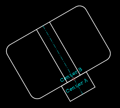

Great, it works.
I’ll save a lot of time.
thank you very much

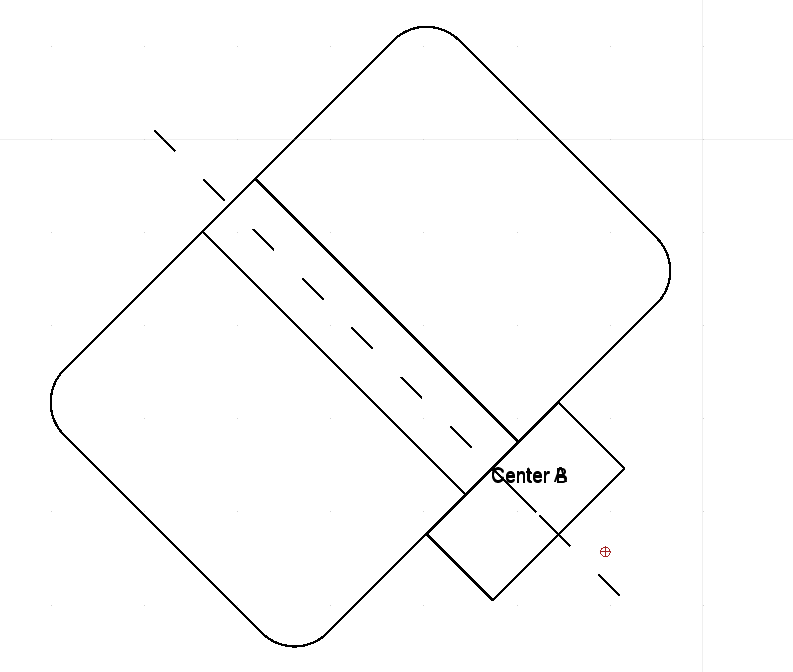

How would you solve that task if the angle isn’t identical? QCAD has a one tool solution for that … :wink:
Goal:
Given:
Practice 1.dxf (105 KB)
Menu | Modify | Align Reference Points (AE)
Tick Source First reference point: Select a center snap (or intersection) at B
Tick First target point: Select a center snap (or intersection) at A
Tick Source Second reference point: Select a snap at B to align
Tick Second target point: Select a snap at A to align with

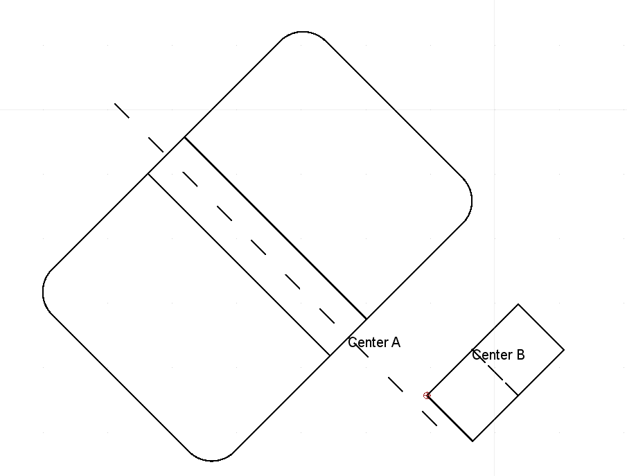

Ok, to answer the still unanswered question: The second QCAD tool to solve the same problem would be:
Move and Rotate (MR)
7k7o_voYBC4
Husky,
I didn’t consider MR:
  • In the original example the shapes were aligned. MV
  • In yours they were explicitly not and the angle difference was not a neat value. AE
  • Off topic: Moving with a known, measured or calculate orientation. MR
The measurement method is tedious and there is a lot to consider for a novice to do it flawless on the first run.
When I follow your steps by the letter, the existing angle value isn’t selected.
What results in 30d1 what is a syntax error.
That way you get a NaN value in the Move and Rotate Options Widget.
“30” is the initial angle value on first use and this is a persistent field displaying any former use.
“d1” is the present first parameter.

The measured angle is reported in the command line as: “Angle: 31.38° [31.38344°]”
The tool tip of the angle fields reports “31.3834”
The Widget angle field too.
C) I find that the information is displayed truncated, what should, but not consistent with my preferences.
Now my first question will be: What angle does it actually use?
Simply “31.3834” raises a warning flag but:
D) I shouldn’t have to bother about the actual angle to start with.
We are aligning things whatever the angles are.
Luckily it uses 31.3834404459263 degrees what is the delta of 202.3661577985517 & 350.9827173526254.
