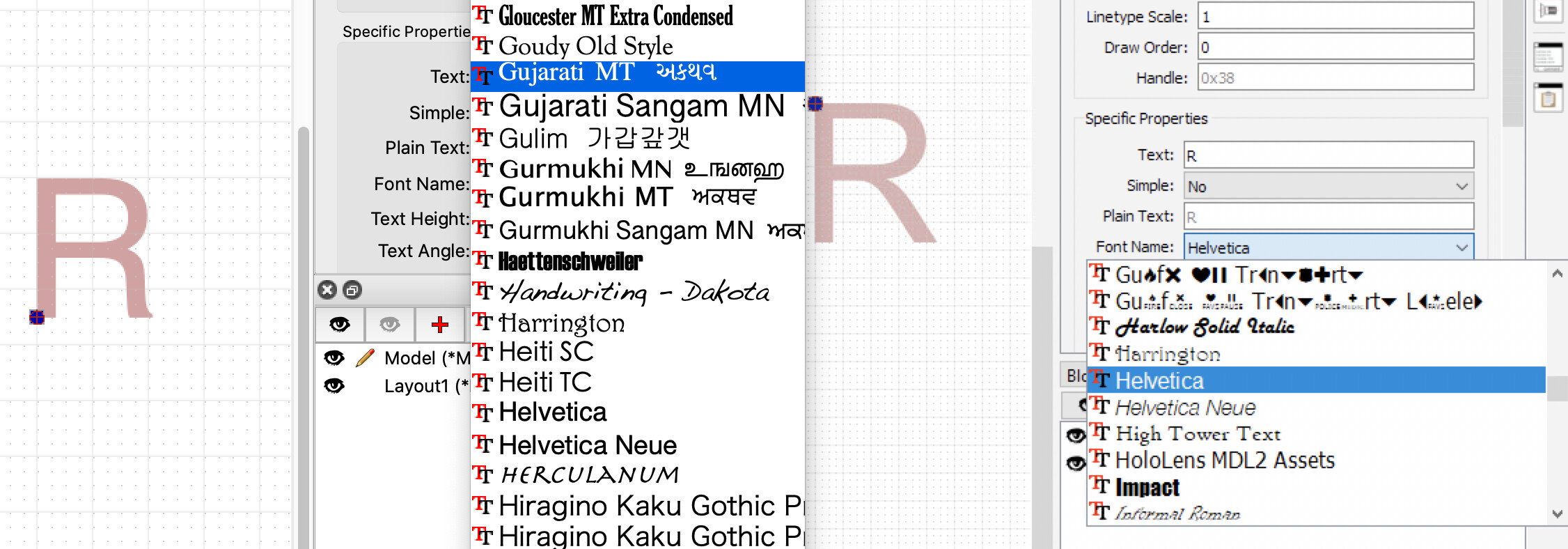

Presuming the screen shot worked, anyone that knows the differences on the two fonts knows that “R” is not an Helvetica “R.”

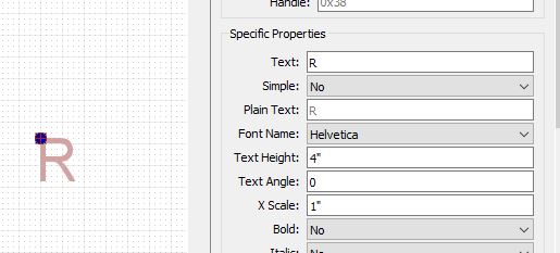

The screenshot I showed was from my office (Windows 10) machine where the list shows Helvetica but the font displayed is clearly Arial. BTW…I opened a new file just for the example so yes, the font is available in the Text dialog box…it didn’t come over via a file.

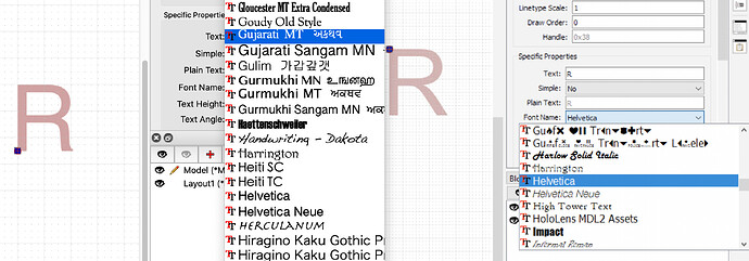

Maybe there is the problem…the “Helvetica” font that is being drawn in the font dialog is NOT Helvetica…it is Arial. As I look at the letters e, t, c and a…they’re wrong. Helvetica Neue, right below it are correct though italics. I have a screen shot that has both Mac and Windows versions of QCAD and both claiming Helvetica but only one really has it.

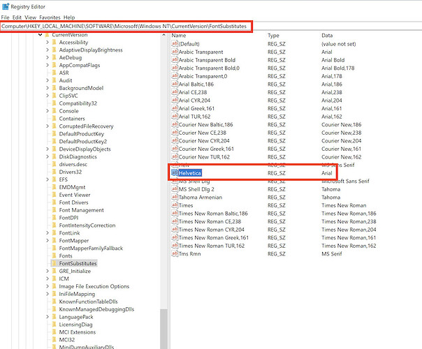

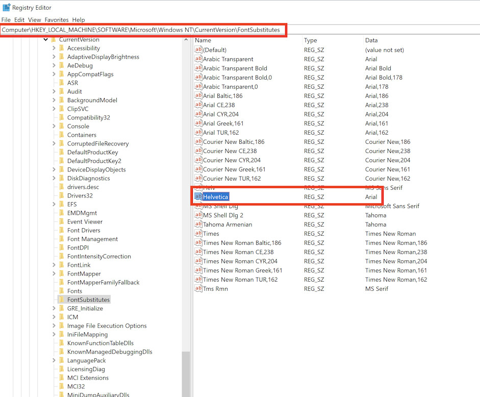

In a nutshell, Windows really likes to substitute Helvetica for Arial. There’s a registry entry that controls that behaviour, under Computer\HKEY_LOCAL_MACHINE\SOFTWARE\Microsoft\Windows NT\CurrentVersion\FontSubstitutes:
If you change that to “Helvetica” with value also “Helvetica”, the effect in QCAD is instantly visible.
