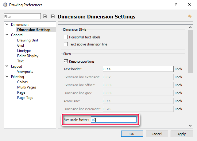

Please keep in mind that if you scale a drawing for printing it will also scale the Dimensioning. To compensate that effect you can adjust the Dim scale settings below Menu/Edit/Drawing Preferences/Dimension Settings. Default is 1 what means if you print a drawing 1:1 QCAD will use the Dim settings 1:1. With other words. Is you Dim Text Height is set to e.g. 0.14 inch it will print it as 0.14 inch on paper.
On the other hand - if you scale a drawing to 1:10 QCAD will also scale the Dim 1:10 … what could make an ink puddle. To counteract that effect you have to scale the Dim settings in this case 10 times up. What means the drawing is down scaled 10 times - the Dim is up scaled 10 times = Text Height 0.14 " on paper … ![]()
