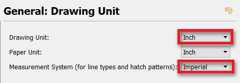

If you are already doing that make also sure that the "Measurement System (for line types and hatch patterns) is set to the correct system - avoids headache in the long run. :wink:
e.g. Drawing Unit mm = metric, Drawing Unit inch = imperial
