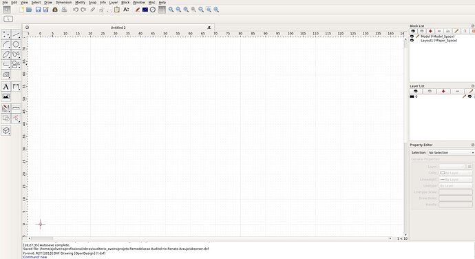

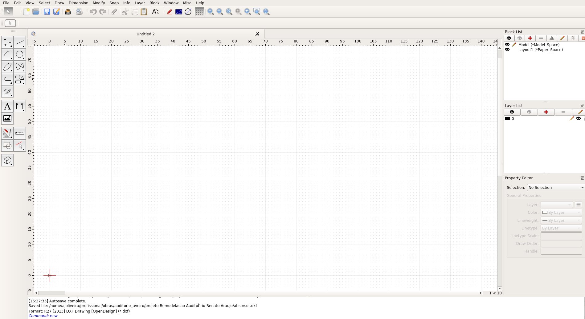

In Linux version 3.24.2.0, Xubuntu bionic 64-bit only an empty toolbar with the current tool is presented when we select the option bar (on image second from top). I do think the Linear Factor should be in Edit-Drawing Preferences or Edit-Application Preferences.
I mean, the only way to alter this factor is select all dimensions and use the Property Editor.

Sorry for the misunderstanding. I thought your question was about the options tool bar being empty. This makes sense, as you have not started any tools. If you start a tool, the tool’s options are displayed in the options toolbar. For example, while drawing a dimension, the linear factor (among other things) can be set in the options toolbar. When drawing a circle with radius, the radius can be set in the options toolbar, etc.

Your observation was absolutely right, if I start the dimension tool I have the scale factor. What puzzled me was the fact that the property editor shows the inverse of the set scale factor, in my case I had the inverse of 0.0465, so 21.505.
The problem is circumvented, yet I think this factor could be in the drawing options-dimension section. It would avoid future questions.
Again, start a dimension tool and you’ll see the option appear in the options toolbar. No need to change the config file.
