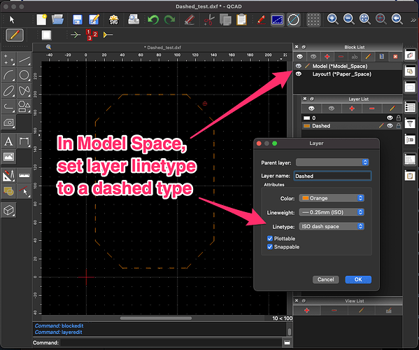

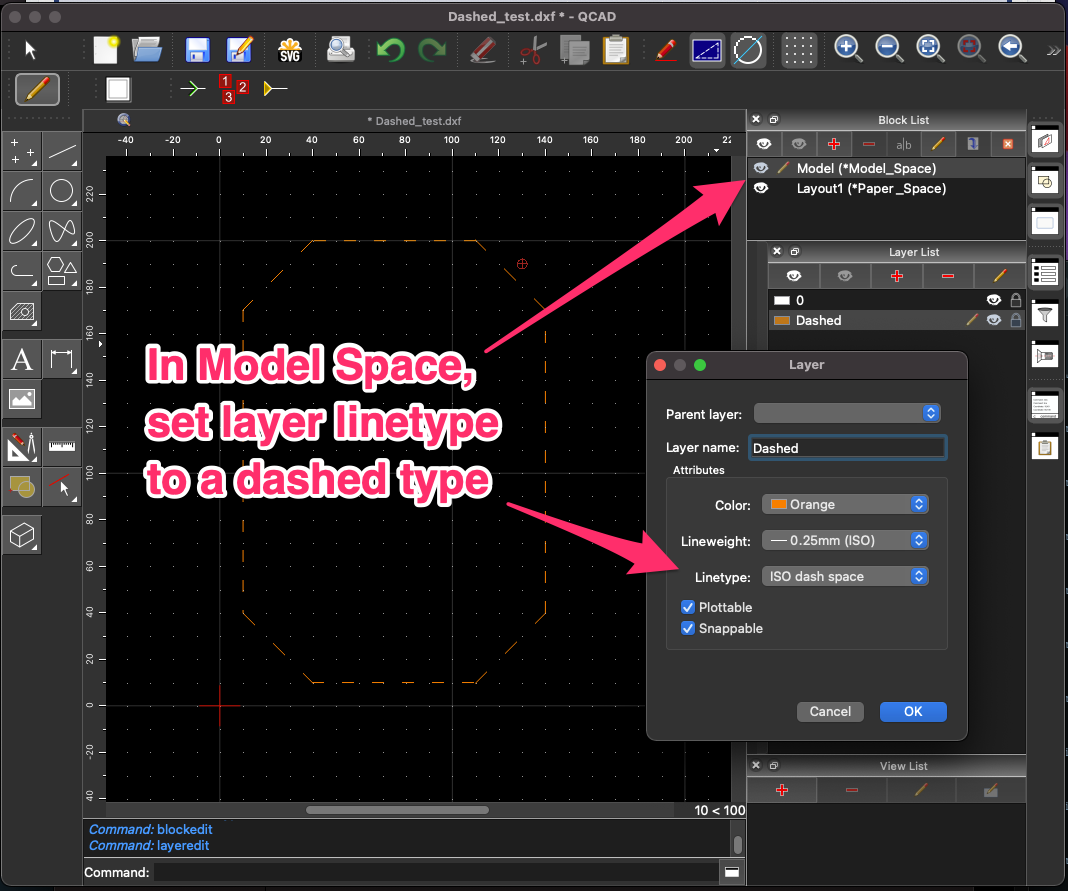

  1. Create a new file and add a layer to the Model Space.
  2. On the layer, draw some point-to-point lines. The lines should automatically have their lineweight and linetype set to “By Layer”.
  3. Set the layer’s lineweight to “0.25mm (ISO)”, and linetype to “ISO dash space”

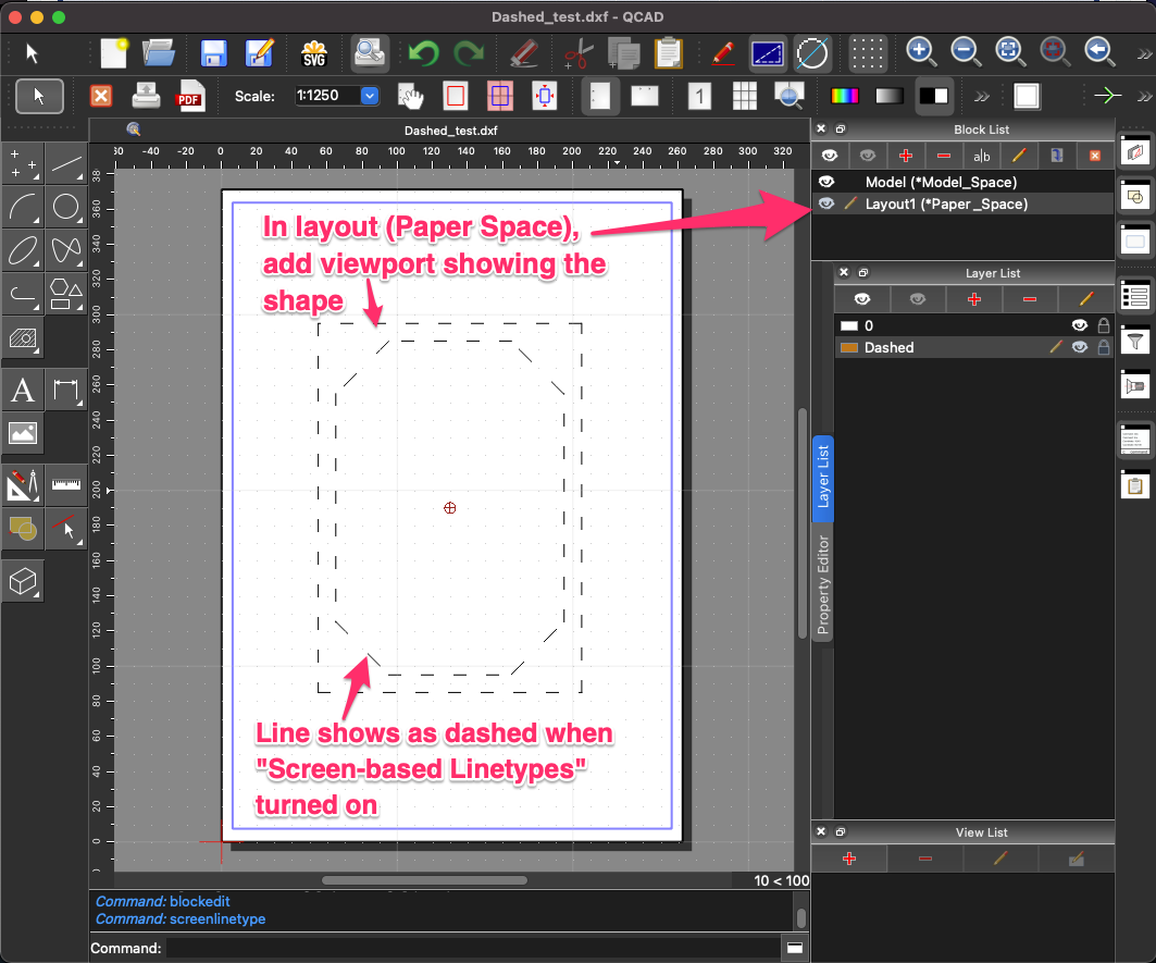

  4. Go to the default layout “Layout1” in Paper Space
  5. Add a viewport that covers your shape. Turn on “Screen-based Linetypes”.
  6. In the layout, your shape should appear with dashed lines

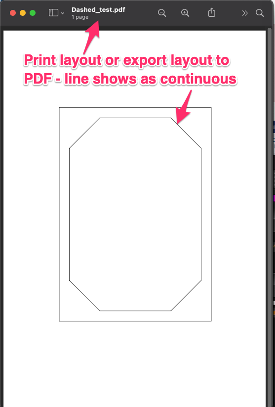

  7. Print the layout (Paper Space) to paper, or export to PDF
  8. Expected result: Printout (on paper) or PDF should show the shape with dashed lines
  9. Actual result: Printout (on paper) and PDF show the shape with continuous lines
This is at least part of the problem. Screen-based line types means that linetypes are optimized for the screen, not for printing. So the print preview now shows something that looks good on the screen but not what will be printed.
