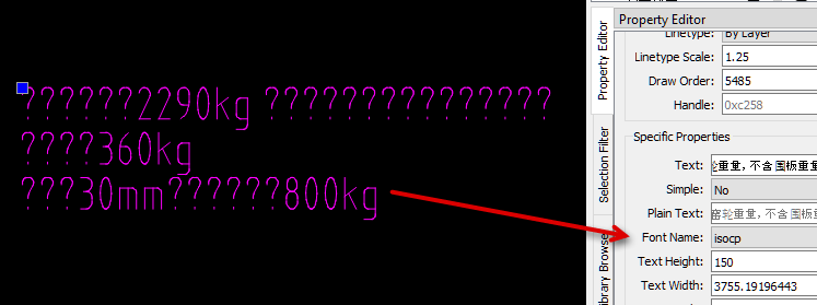

I’m using dwg2pdf command to convert a drawing file.
But all the Chinese words couldn’t be converted correctly.
-font-substitution not working either.

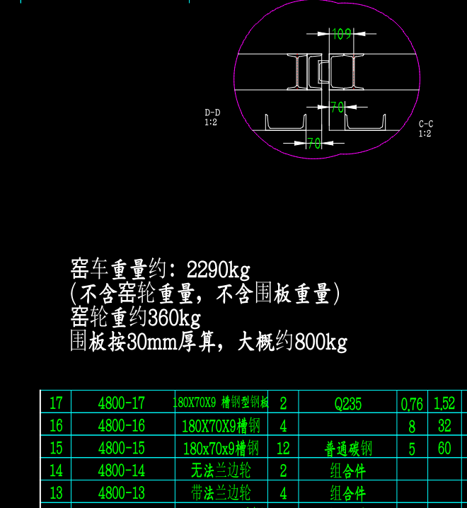

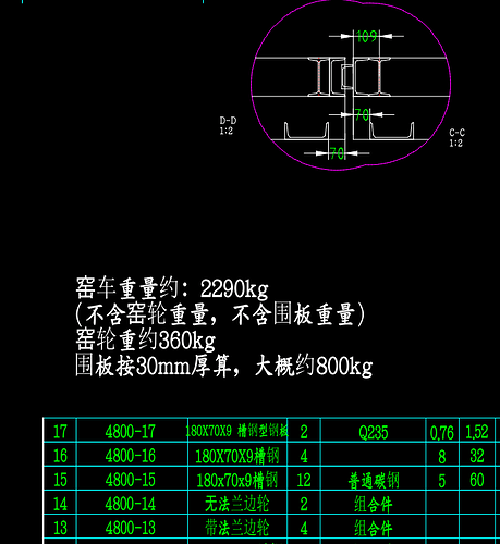

I assume that the in the dwg used font isn’t installed on your machine.
As you can see it’ll work if you have a font installed which can properly interpret the used characters. If not it will display an ? as a placeholder. BTW: I can’t read Chinese - please consider my screenshot just as proof of concept. :wink:

But I don’t know which font the users use, how can I determine the font (or font name) the file uses? Then I can find and install it, or replace it with an existing one.
Good question! In a perfect world you just load the drawing. If you then notice that something went wrong with the text you just select the text and check the Property Editor to figure out which font was used. Then get the font, install it on your system and everything works as expected.
If I do that with your example drawing it will show that the “isocp” font was used. As we see that can’t be correct what means this font is already an automatically substituted font during load or somebody who work previously on that drawing substitute the font and saved the drawing before you got it.
What I did to come close to a fix was just a try and error attempt. I know it has to be a font with Chinese characters, so I tried a Chinese font which I had on my system (HanWang KaiBold-Gb 5) and hoped for the best …

What is the most intriging is that:
  • Specific Property Text field
  • Specific Property Plain Text field
  • Text dialog
    All show chinese characters but the text in model space renders as ‘???’.
The Block List and the Layer List show chinese characters too.
I have ISOCP.ttf installed but the font dropdown field shows ‘isocp’ as last at the bottom.
Meaning that ‘isocp’ is not the same as ISOCP.ttf as that sits higher in my font list.
Another test is to alter the font and verify if ‘isocp’ is still listed at the bottom.
In this case it disappears meaning that the font is not present on the system.
