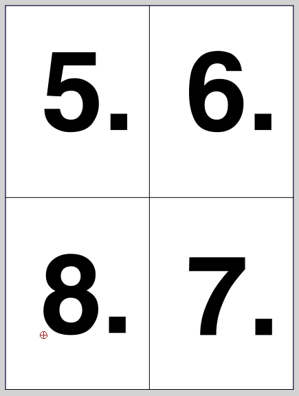

QCAD layout block looks like this:

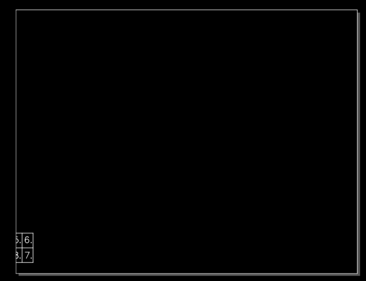

same drawing in ACAD looks like this:
I teste this in QCAD 3.20.0-pro and 3.27.8.0 - same result!
