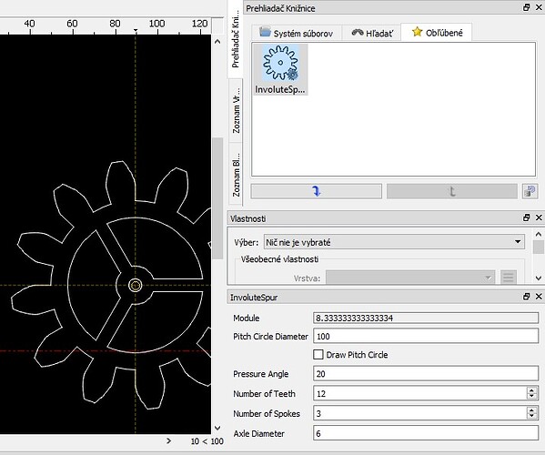

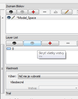

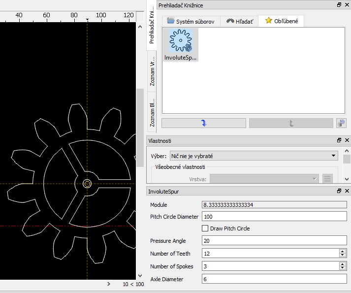

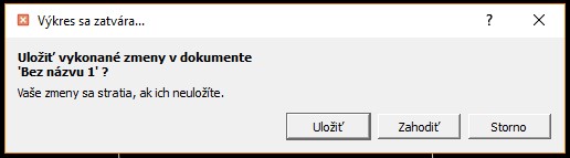

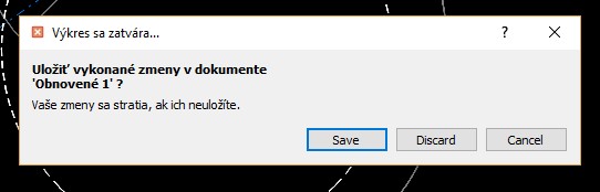

I have problem with translation, I didn’t find some things and something was not translated - have a look at pictures. Could anybody help me?

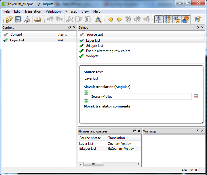

The ZIP file you’ve attached contains translations for the free community edition of QCAD.
Some menus, tools and widgets are only available in QCAD Professional or replaced by QCAD Professional versions (e.g. the layer list).
You can test if your translation for the QCAD Community Edition is complete by installing the QCAD Community Edition:
Be sure to remove the trial plugins from the downloaded package.
If you wish to also translate the QCAD Professional add-on, you can download the translation sources (.ts) from here:

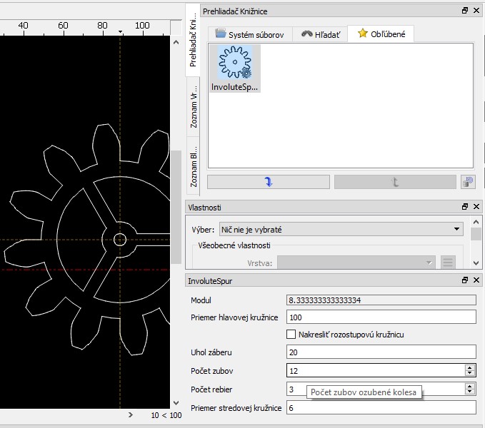

translate … library - gear
Involute Spur Gear                  <=>  Čelné ozubené koleso
Pitch Circle Diameter               <=>  Priemer hlavovej kružnice
Draw Pitch Circle                   <=>  Nakresliť rozostupovú kružnicu
Pressure Angle                      <=>  Uhol záberu
Number of teeth the gear has        <=>  Počet zubov ozubené kolesa
Number of Spokes                    <=>  Počet rebier
If non-zero, spokes will be drawn   <=>  Ak je hodnota vačšia ako 0 bude rebro nakreslené
Axle Diameter                       <=>  Priemer stredovej kružnice
Number of Teeth                     <=>  Počet zubov
Module                              <=>  Modul
qcad-3.12.4 vs qcad-3.16.0
I found the solution to the problem (see my previous message).
It can be fixed by this file: qtbase_sk.qm (I attach it)
qtbase_sk.zip (46.5 KB)
Thanks. This should be included in distributions starting with QCAD 3.17.2.
