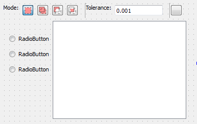

Hello riverbuoy,
Thank you for your help.
I answer to your question
Q1) Is there a reason why you cannot put your command button in the options toolbar?
A) in my widget there are some other ui objects as the example below:
In the toolbar all the objects will be horizontally squeezed.
Q2) Do you want a script to pause while the SelectContour command is active?
A2) No, i do not want the script to pause.
i agree, the toolbar would be the most convinient area where to place my widget.
Therefore the problem is how to create toolbar widgets that are not squeezed?
Plane

Hello Riverbuoy,
Yes, I have radio buttons that i could arrange in a dropdown list.
The main problem is a Table where I need to show all the elements of the selected contour, including their corresponding start and end points.
At last i am afraid I would have to arrange this in a dropdown list, but then too many dropdown lists…
if i could increase the size of the toolbar then i could better arrange my user interface.
