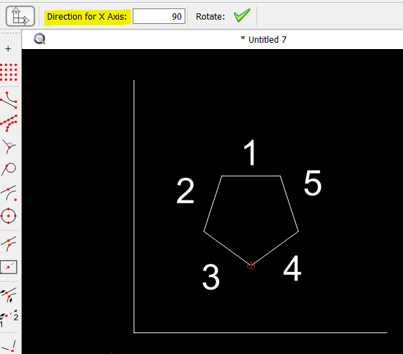

Example 1.
I came up with three commands.
  1. ‘ucs’, shortcut ‘UC’.
    This allows you to set a direction for the X axis.
Figure 1. The ucs toolbar.
Figure 2. The command line prompt.
You set the direction in the options toolbar, or you can select an entity and its angle will be put in the direction box. Not all entities have an angle associated with them. For example arcs, circles, polylines etc. do not have an angle property, so if you pick an entity that doesn’t have an angle, an error message is shown in the command line, but you can continue to select another entity. Once you have set the angle you can click on the ‘Tick’ icon to run the command, or alternatively you can press the ‘return’ or ‘enter’ key on the keyboard to run the command.
The ‘direction’ is actually an angle which is aligned with the X axis. If you draw a line parallel to the X axis, going from left to right, it will have the angle represented by the X axis when the drawing is returned to its original orientation. In the example above, setting the direction to 72 will rotate the drawing so that side 2 of the pentagon will be horizontal to the X axis. Any lines drawn parallel to the X axis, going from left to right, will have an angle of 72 degrees. Lines going from right to left will have an angle of 72 + 180 (252) degrees.
(Note: you can use a mathematical expression in the box, so to get side 3 parallel to the X axis you can enter 144 or ‘2*72’).
Also note that the value in the direction box is an absolute value, and not a relative angle.

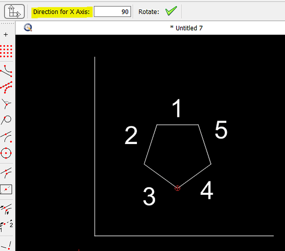

Hello riverbuoy,
I think this is a typical situation between a programmer and a 0815 user. Probably we wont come on the same branch but here are a few addional thoughts - and I’m sure similar questions would be ask by other user …
That is why I’m confused - the result doesn’t tells me what I did. The result shows me that I rotated the drawing around Absolute 0/0.
X/Y has still the same orientation like before. If I switch the grid on - same orientation. If I then use other tools - same orientation.
Long story short: The UCS isn’t rotated, only the drawing. The name “UCS - Set direction of X axis” is misleading in my eyes.

Hi Husky,
Sorry about the confusion. I think my explanation was poor, so I will try again. Here goes…
First ‘Direction’. We normally give directions using points of the compass, such as EAST, WEST, NORTH, SOUTH, SOUTH-WEST, NORTH-EAST etc. However these are imprecise, so navigation systems, and surveyors, etc. use degrees, minutes and seconds to indicate precise directions. So when you start a new drawing the X axis points EAST, or zero degrees. So although we are using degrees, we are using them to represent a direction, and not a rotation.
The X and Y axis are fixed on the screen, so they don’t move. So to get the X axis to point NORTH, for example, we have to rotate the drawing 90 degrees clockwise, or 360-90 = 270 degrees counter-clockwise. The result is the same. Now the X axis is pointing NORTH (90 degrees) on the drawing. This is the same as rotating the paper on a drawing board.
Why you would want this?
If you were drawing the floor plan of a pentagon shaped building, for example, it is much easier and quicker to do it if the walls are parallel to the X and Y axis. As you point out, QCAD has tools to allow you to draw lines at any angle, but when laying out floor plans, this feels unnatural and slow, and prone to introducing errors.
