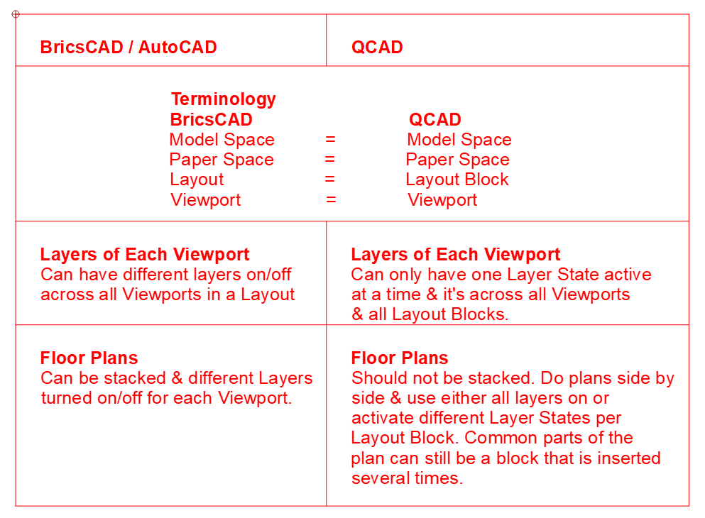

Most of my work is architectural. I have read a lot of posts on this forum on setting up drawings.
The table below might be of use to anyone transitioning to QCAD from BricsCAD / AutoCAD. It summarises differences & similarities between the CADs.
Any comments or errors is welcome.
