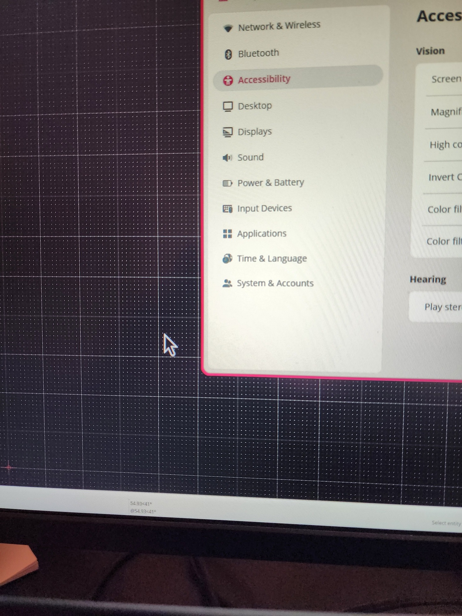

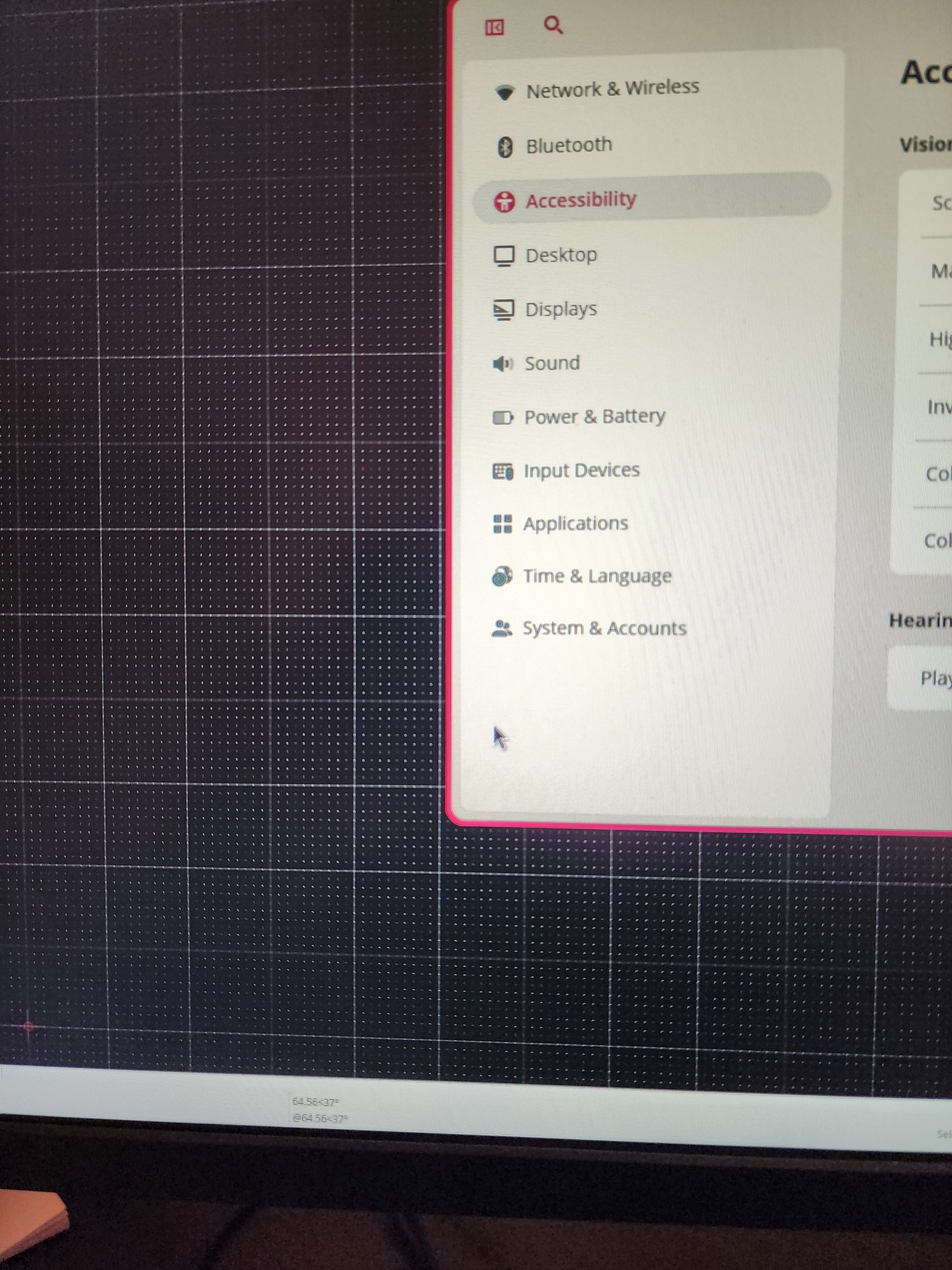

Since re-installing QCAD I cannot get the cursor to the right size - if I got outside the QCAD display the cursor drops to the right size.
My external screen is 23.4" @ 1920 x 1080, 60Hz & scale 100%.
I have screen pics of cursor. In QCAD quite large, move onto open app and cursor drops to proper size.

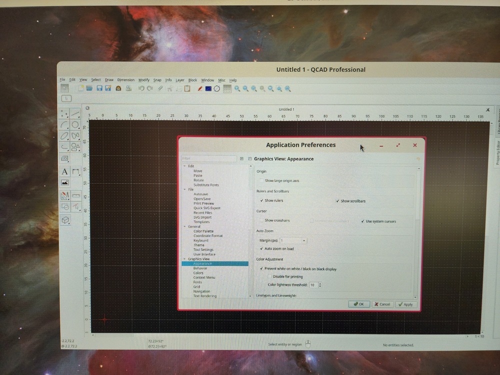

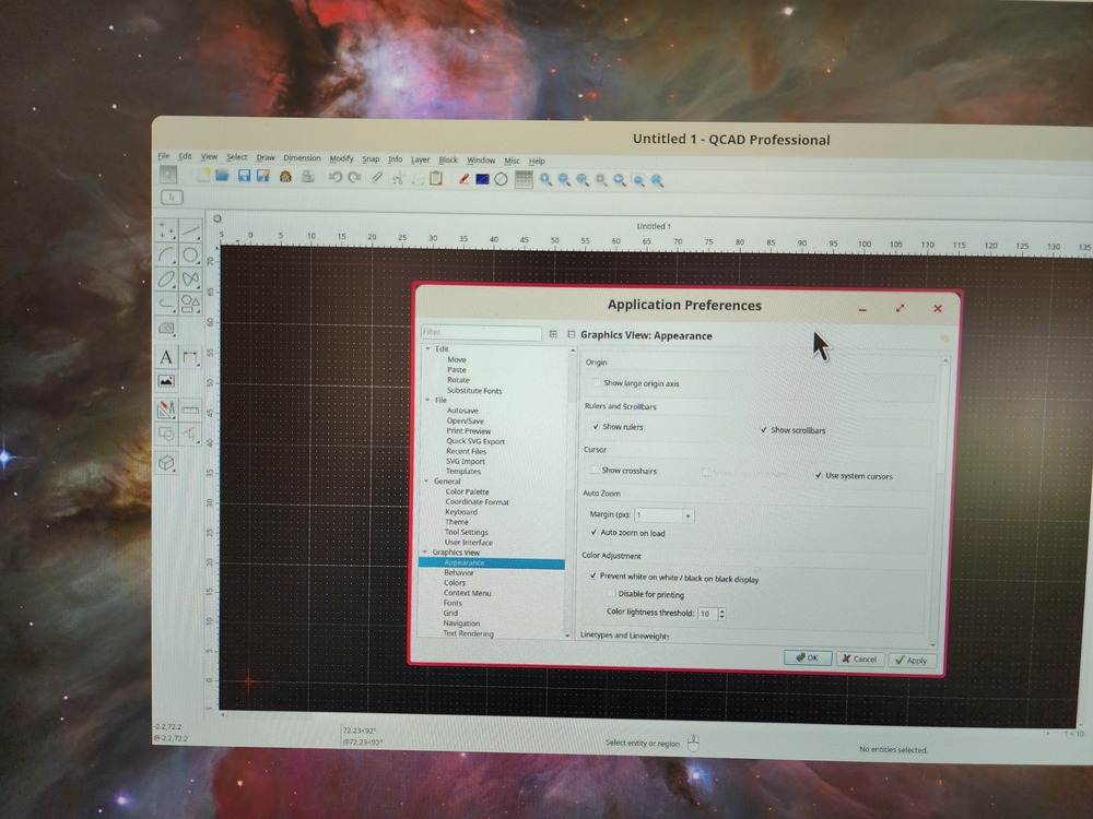

Does anyone know how to change the cursor size? I have looked in App Preferences - Graphics View - Appearance but can’t find anything to change.
Please refer to:
Recommended link option does not work. I have it set to system cursor.

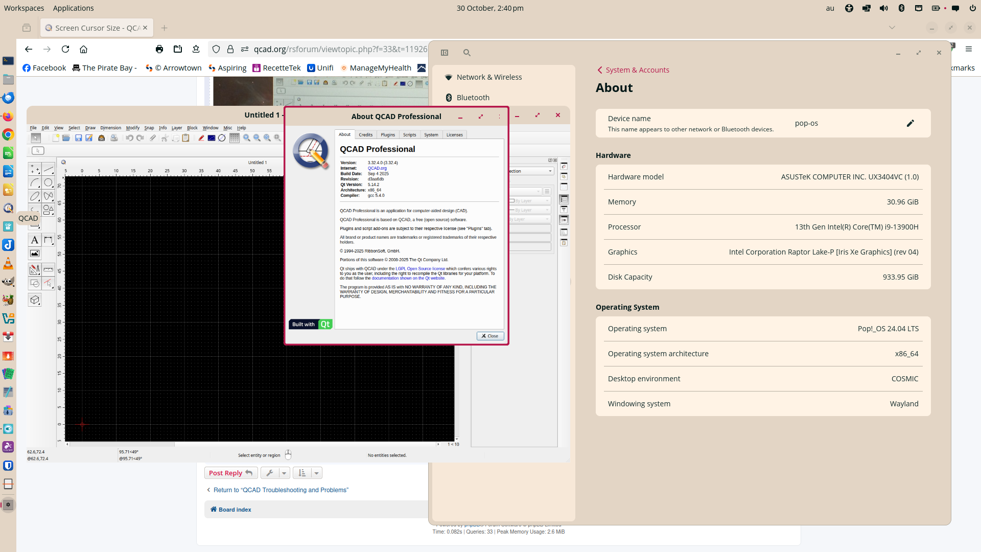

Can you please indicate your exact QCAD version and if you are using Wayland or X11?
Please see attached screen shot

Also: did you try to disable system mouse cursors and use the Qt mouse cursors instead?
Have tried on laptop with same results.
How do you disable system mouse cursor and use Qt mouse cursor?
