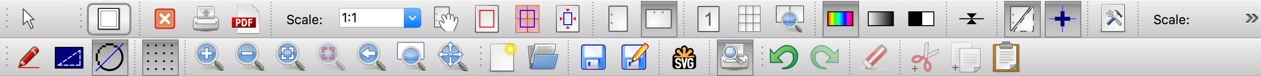

The scale of the viewport is shown to the right. I suspect that you might be on a screen that is too small to show that.
Thanks, now i understand. However the reason I didn’t see it is that it is actually impossible to access that menu item on a MBP 13 as the included attachment demonstrates.
In order to view it it is not even possible to click the “more” button but you really have to also move the left reset button to the second line since all the other icons seems to belong to the same menu as the scale (and that is after moving all the other normal menu items to a second line). So in the screenshot shown it is not possible to access it unless also the reset-arrow is moved to a separate line.
So I don’t feel so bad that I missed that menu entry, it was like an archaeological dig to find it hidden (none of the “more” arrows shows this entry in the default menu on MBP. Even on my 15" MBP it does not by default show without heavy re-arrnagement of the menus :slight_smile:
