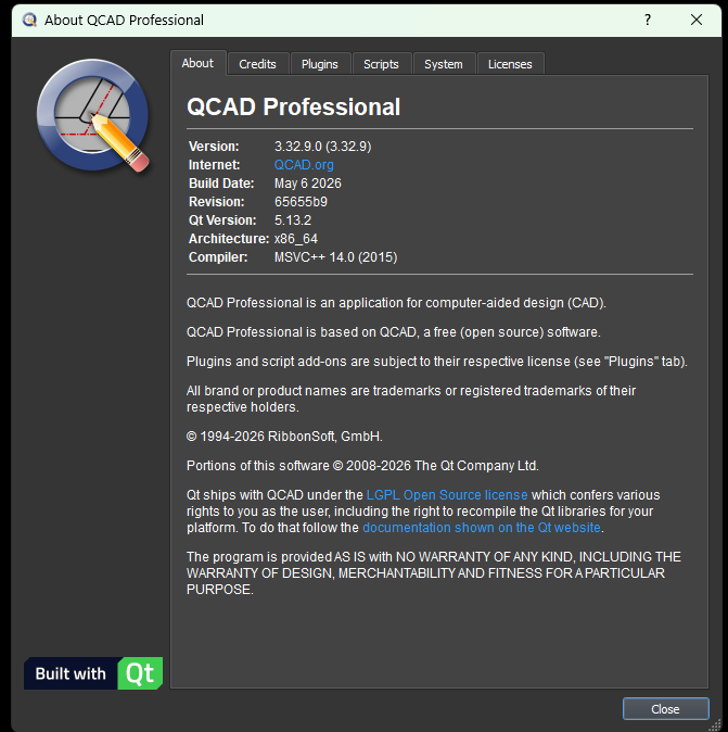

I just installed version 3.32.9 (qcad-3.32.9-pro-win64-installer) using the QT5 windows download and all is working better. I also deleted the configuration file and started fresh just to make sure. It looks like a problem with QT6 for some reason. Screen shot of the popup attached for reference.
