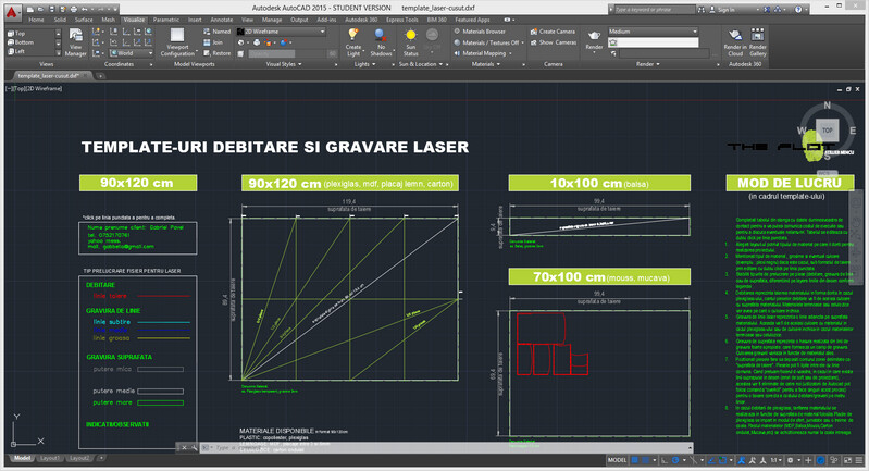

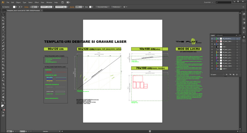

Hi gabbello
Your file opens fine in AutoCAD 2016 and Adobe Illustrator Cs6 - no problems for me.
