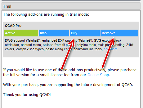

If you launch a trial version of qcad it will show you a window at the right lower corner like this one:
You can remove the trial features with “Remove” (eventually you need to run the application as an Administrator). That will bring QCAD permanently in the free “Community Edition” Mode.
If you are satisfied with the Professional features and you will use them without limitations then you can use the “Buy” button to purchase the software.
