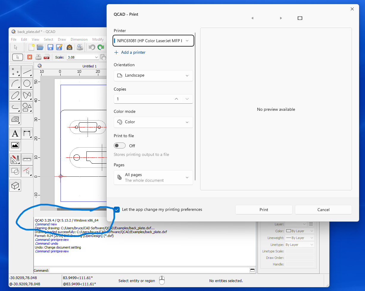

    QCAD - Print
    Printer: (to my laserjet)
  • Orientation
  • Portrait !!THIS IS WHAT SHOULD BE LANDSCAPE!!
  • No preview available
  • Print button
  • Drawing is printed Portrait
Bruce

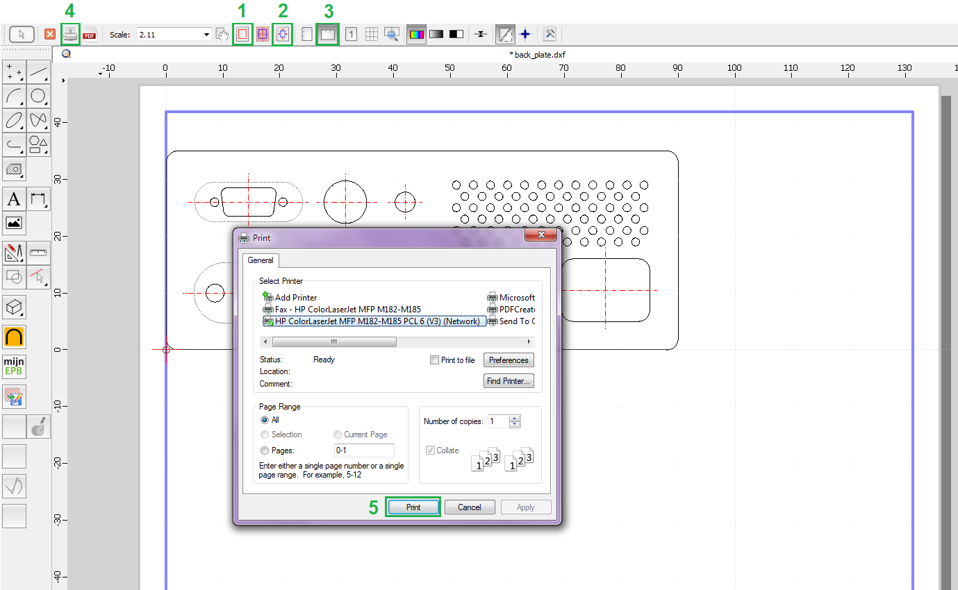

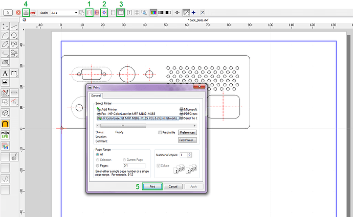

What I get is shown below.
QCAD shows the print preview and I am about to send that to the selected printer with hitting the ‘Print’ button (5).
The printer dialog does not shows a preview for the simple reason that noting is send to any device yet.
You are about to select the export device.
That might be different if you are actually going to print the content of an existing file, of something to show.
But that is directly with your printer driver dialog …
Here I can access the printer preferences and there I also have finishing options: Portrait - Landscape - Optionally rotating by 180 degrees
With the former HP printer that I owned I could request a preview before actually printing.
My newer HP laser driver is not equipped with that.
I can access … But I don’t made any changes to any printer preference because it prints just fine from withing any application.
If I hit the ‘Print’ button (5) I get exactly what I see in the QCAD print preview.
The Back_Plate is printed in scale 2.11 on a page in Landscape, arranged somewhat left - high. (WYSIWYG)
(About 140 wide in scale 2.11 is about 295.4mm what is a good match with the paper size)
I then suspect that the additional steps between ‘Toolbar ICON: Print’ and ‘Print button’ customize the export.
What happens if you simply acknowledged for printing?

Thanks for your attention to my issue. I have been unsuccessful inserting a screen shot after I select PRINT. I am not presented with the same print screen as your image, but rather a dialog bow titled “QCAD - Print” with ‘Printer’; ‘Orientation’; ‘Copies’; ‘Color mode’; ‘Print to file’; ‘Pages’ items listed down the left side of the ‘QCAD Print’ display with “No preview available” where a print preview might be displayed; with “Print” “Cancel” buttons at the bottom of the “QCAD - Print” dialog box.
My inital thought of a simple explanation/solution to this issue is evaporating. The differences in behaviors and environments are over-shadowing the inital issue.
That doesn’t sounds like the Qcad print dialog. That is assumingly your printer driver
Please attache a screenshot:
How?
Also:
To attach a screenshot you must first save that as an image file … :wink:
Looked it up in code … Print calls for a new QPrintDialog
If we look that up we are automatically re-routed to Qt6.6 and that print dialog has indeed a page format group:
QPrintDialog Class | Qt Print Support | Qt 6.10.2 (Almost halfway on the page)
There is no print preview area shown …
… If we read further: On Windows and macOS, the native print dialog is used, …
Mine looks exactly like the Qt5 Printer dialog:
https://codeloop.org/qt5-gui-how-to-create-qprintdialog (Almost at the bottom of the page).
I already predict a native printing dialog issue with Win11 … :wink:
Husky & CVH,
Much patience on both your parts… thanks for the pointer for attaching screen shot.
There are some opaque, moving parts to this issue. It wasn’t obvious as to the Qt printing component, but I see the reference (Qt 5.13.2) in the Command Line box. It’s good to have someone with inner working knowledge, CVH.
Not sure of Print Dialog Box origin; QCAD|Win11|HP driver environ, but it is different from yours, CVH. How much of this falls into the category of “it is what it is” vs. something that can be manipulated to accommodate, might be the direction of the answer.
For now, I will pay attention to the settings in the Print dialog box before sending to printer. I will ‘watch’ for any further info in regards.
Thanks,
Bruce
