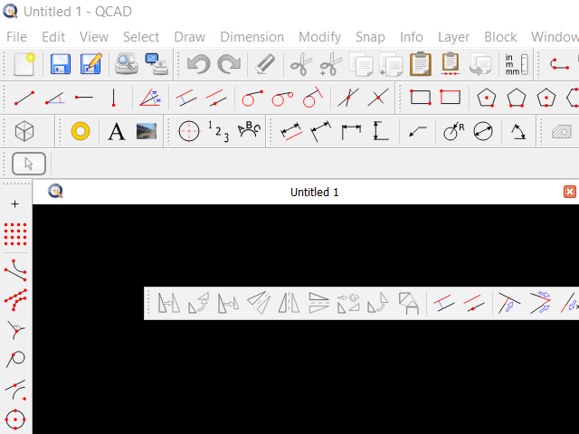

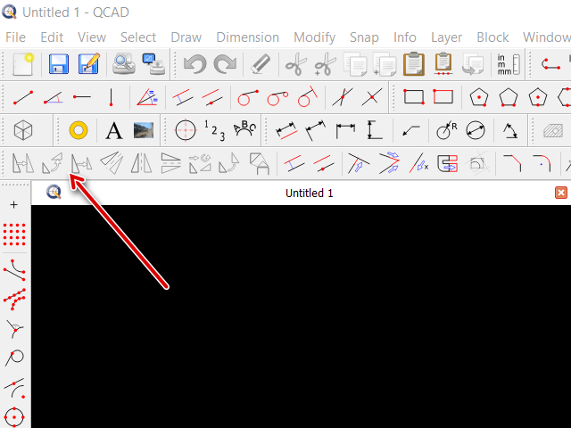

You can place Toolbars, Widgets etc on two ways: “floating” or “docked”. Docked means that it will “melt” into the QCAD interface.
Example floating:
Example docked:
There is no way to “Lock” the position permanently - you have to learn “to control” your fingers e_surprised
Note: Every setting, layout in QCAD will be saved automatically in a file called qcad3.ini in the moment when you close QCAD. Maybe it would be a good idea during this “learning curve” to backup this file and use it in the case that you accidentally busted your layout.
