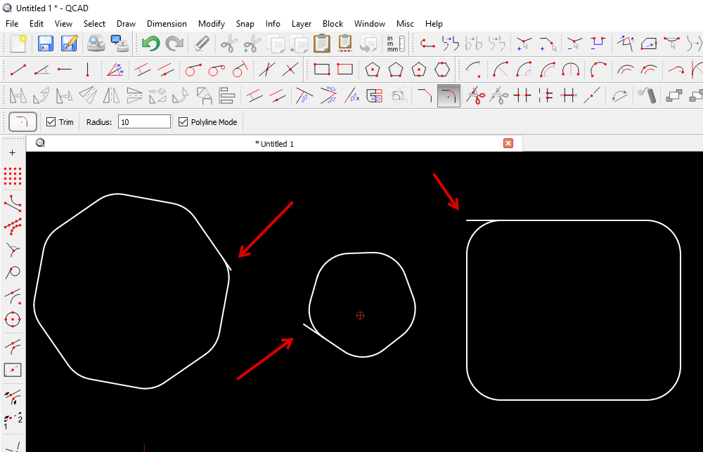

if I use the polyline mode to round all corners of a polyline then it fails always at one corner. Do I need to change some kind of setting to get all corner rounded?
It’s a known problem with closed polylines that has been fixed meanwhile. You’ll have to trim the start segment manually for now.

Nice work indeed. This is now sorted in 3.21.3.17 ![]()
