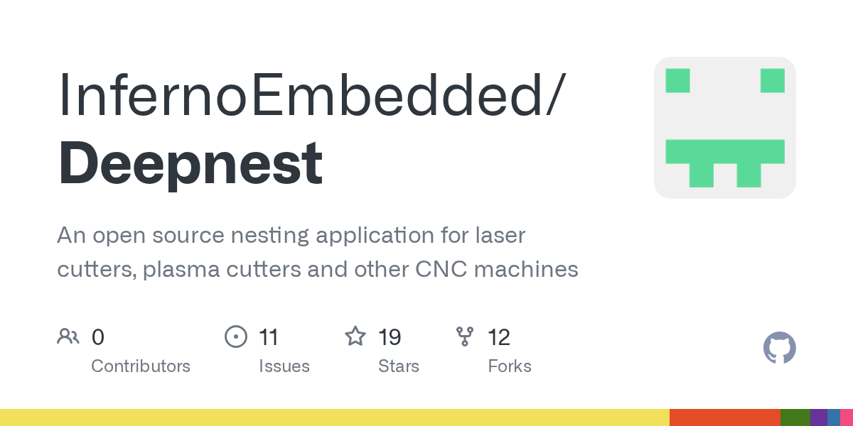

There is a fork with later commits:
Deepnest is based on SVGnest from the same author.
Last commit there is from april 2019.
Deepnest and SVGnest topics are spread over many sites and pages.
