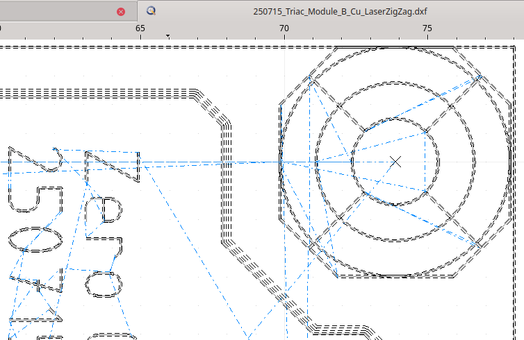

In 250715_Triac_Module_B_Cu_LaserZigZag.dxf I did use the LaserGRBL post-processor, and creating the Inside and OutSide toolpaths was not a problem. Even using alias tools to widen the distance btetween the tracks was not a problem.

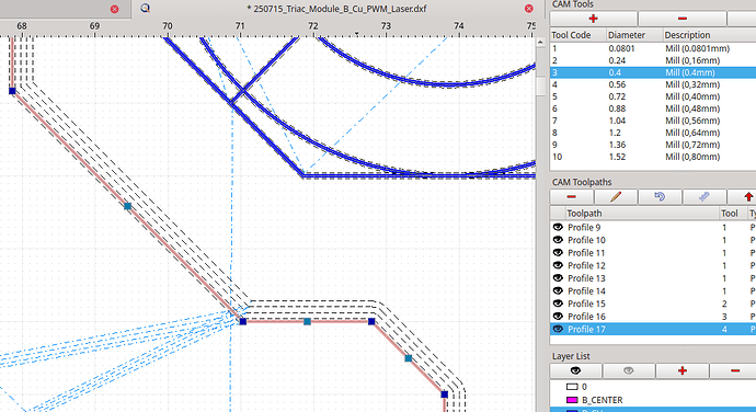

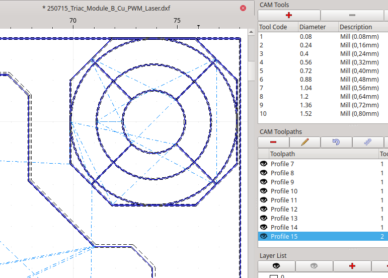

I am getting older and forgot that my laser cutter uses the PWM Laser post-processor. So, I have to redo the same job over again. Using the very same B_Cu file, I now encounter a very odd and curious behaviour when creating the outside toolpath at a distance of 0,04 mm.
More odd, when using an alias tool on that same outline, that toolpath is created without problems.

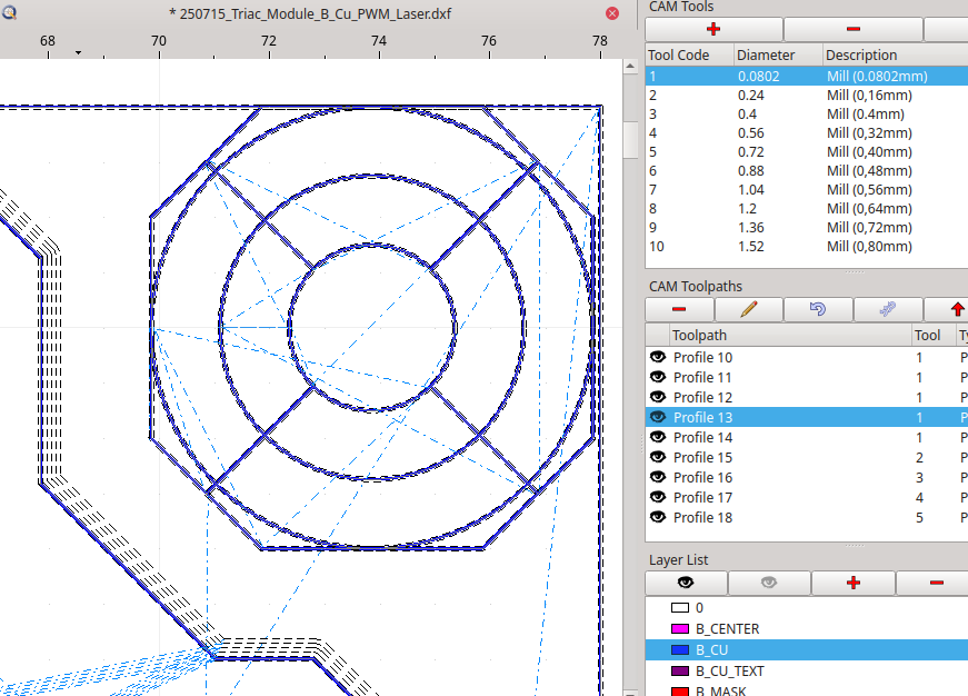

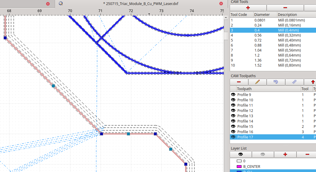

Therefore, I suspect there is a toolpath-rounding-problem. To test this hypothesis I have changed the T1 tooldiameter from 0,08 to 0,0801 mm. The outside path is now created correctly, BUT now the inside toolpath gets corrupted!
Can it be a divide-rounding-problem? I have changed T1 tot 0,0802 mm. And low and behold; the inside and outside path are now created correctly.
Seems to me like an odd and curious bug in the toolpath-program.
