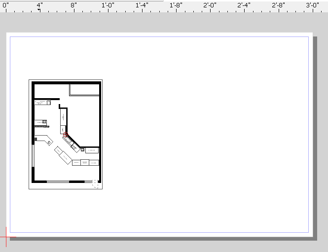

I am trying to print after drawing my model at 1"=1" in Model Space. I set up Paper Space with a landscape ArchD 24"x36" border. Paper space is set to 1"=1" and I inserted a Viewport at 48"=1". I did these things after reading the manual. I want the viewport to be at 1/4"=1’-0" scale. (However, that did not work and only setting it at 48"=1" worked visually).
My problem is that there is no Print Preview and when I attempt to print to a PDF the page is blank. How can I fix this?

(I attached the screen capture to show what the drawing looks like in paper space)
