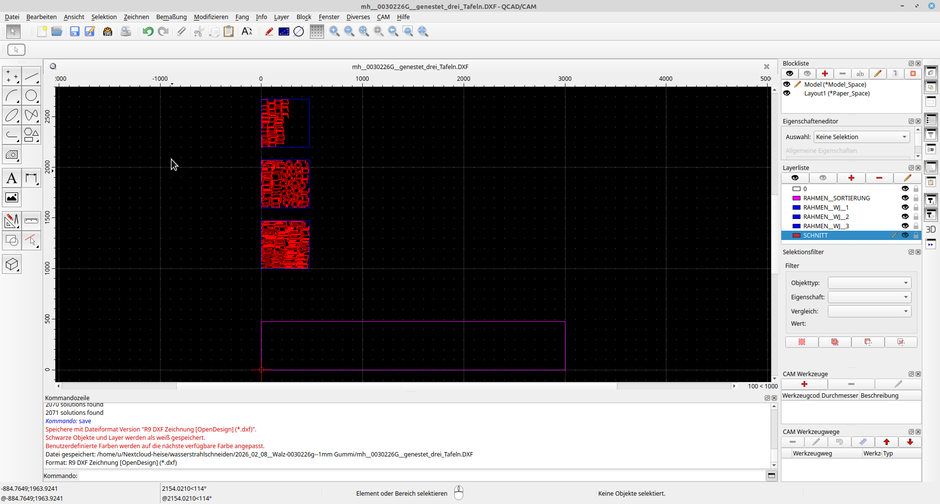

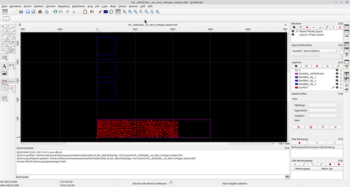

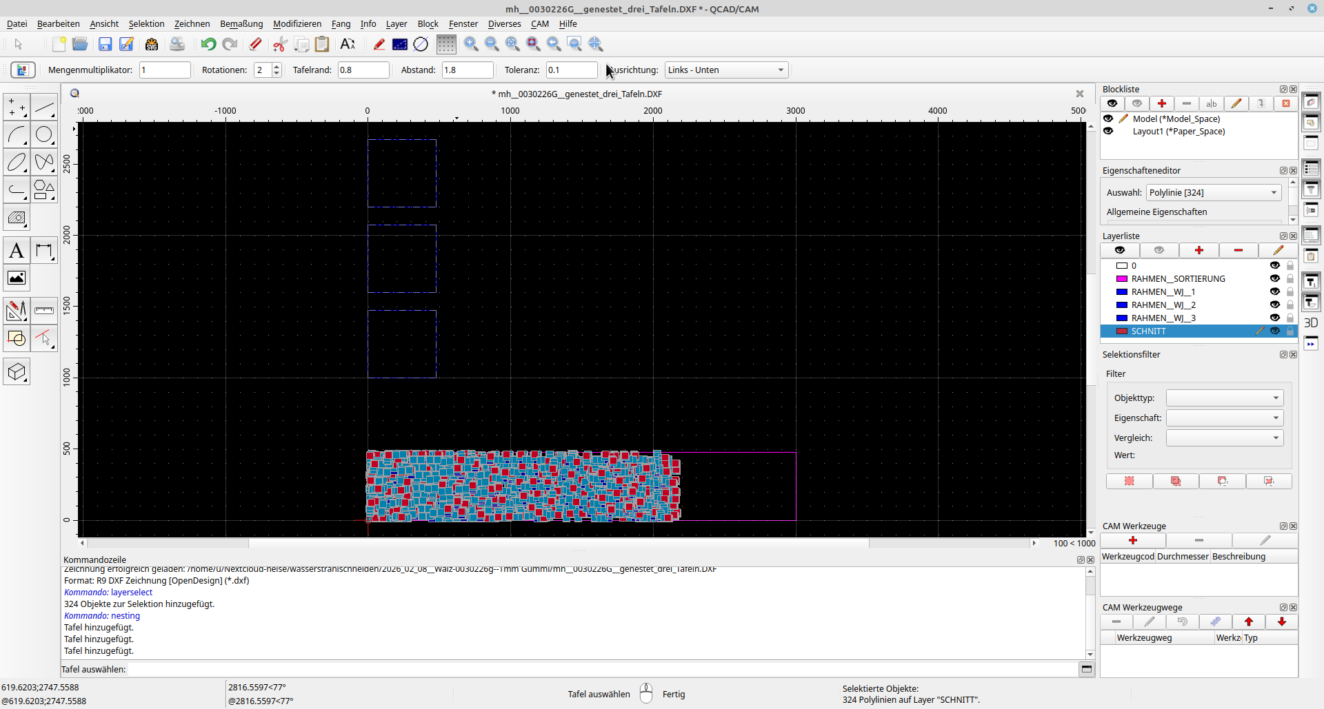

I am regulary nesting shapes with QCAD before I cut them on the machine. I stay within QCAD, the machine’s software can read DXF. I convert the shapes into polylines and then nest them.
The attached files are showing a typical job for me, on the smaller side for my work, but a good example.

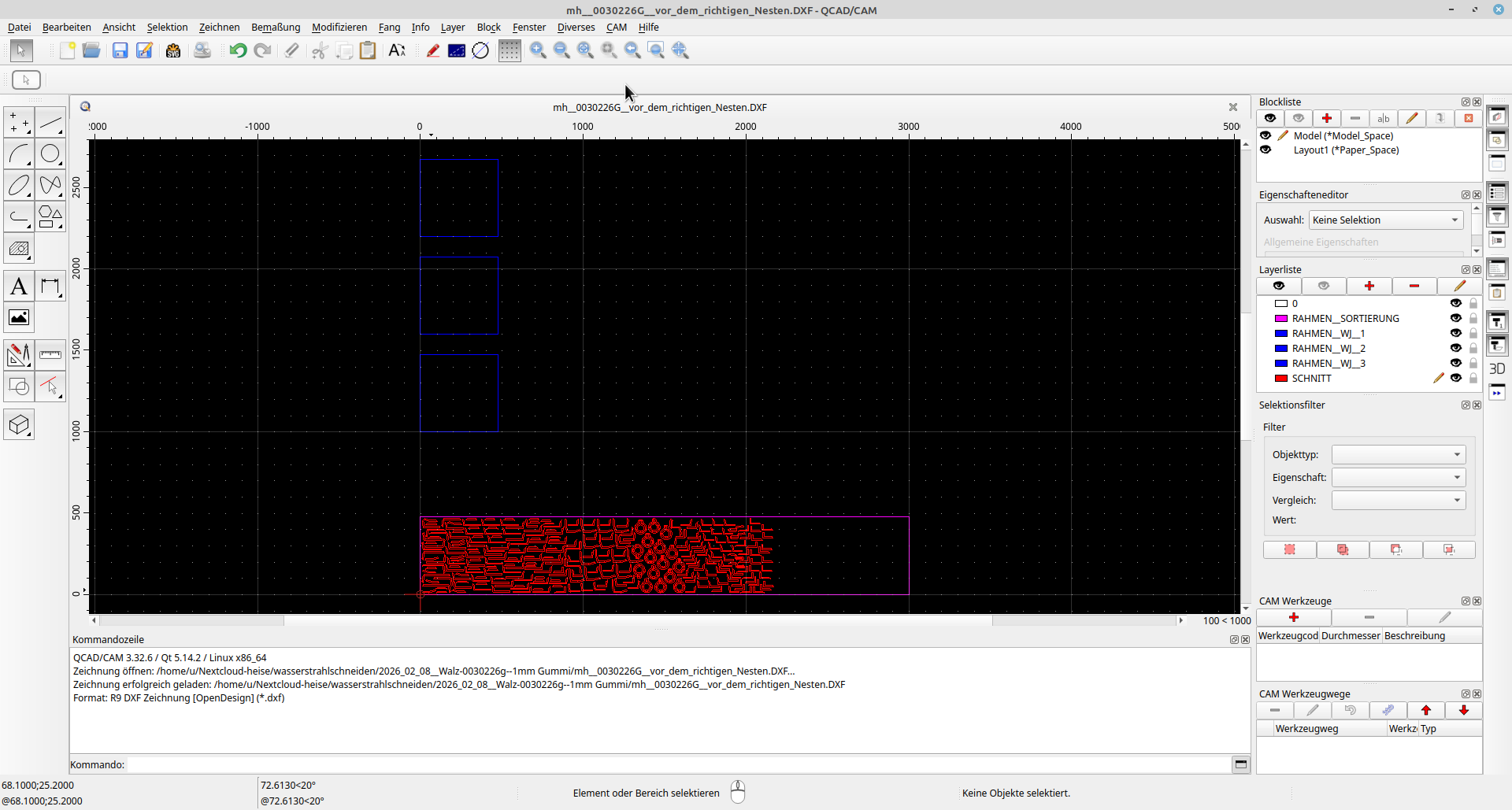

I first “nest” the shapes into a rectangular box to check if all shapes are closed, sometimes the data is not accurately closed, then I have to manually correct. But this is step is already finished in the attached file and not shown. The shapes/polylines to be cut are in the layer “SCHNITT”, the rectangular box for the first sort is the on the layer “RAHMEN__SORTIERUNG”. This is my preparation.
Then I nest for the cutting/production all shapes from the layer “SCHNITT” again to the sheets on layers “RAHMEN__WJ__1”, “RAHMEN__WJ__2”, and “RAHMEN__WJ__3”. Which are the sheets of material to be cut on the machine.

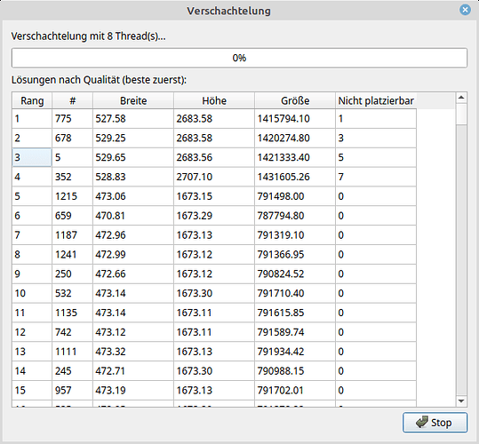

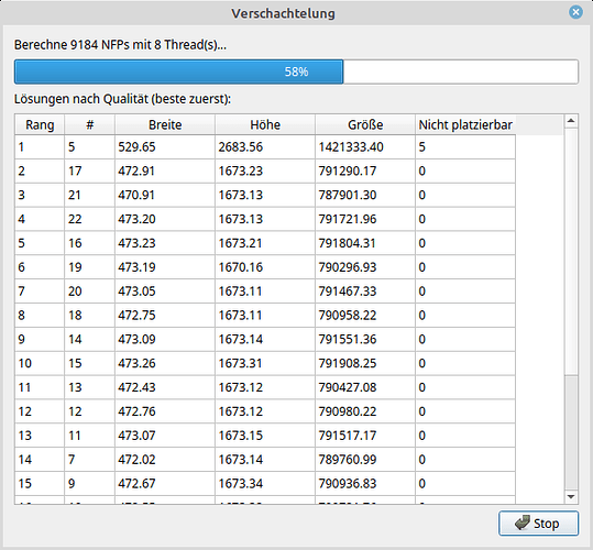

And the results of the nesting with QCAD are good, just the ordering of the results as displayed on screen is broken. None of the real optimal results are shown first in the list. On this job there are just a couple of wrong results, but on other jobs I get pages over pages of wrong optimal results shown before there is any real result.
So what am I doing wrong ? Am I seeing a bug ? Or is this a problem that I am causing myself ? How can I have the sorting so that results with 0 of not placed objects are always shown first ?
It is a nuissance for me, because usually the nesting takes quite a bit of time, especially on bigger jobs, and then I just stop by the computer every once in a while and I would like to be able to see at first glance if a real result has been found and not having to scroll through pages of false optimal results that are no results at all ? The false results are especially often shown if the nesting is a tight fit for the sheets of material on the machine.

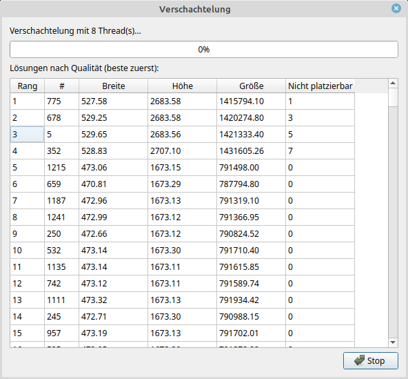

In the end the sorting of the results in the list is just wrong. In the example I gave the “not a solution” placed at the list top cannot place 5 shapes and has a much larger area. That is not a solution at all, and it should simply not be shown.
