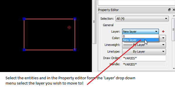

Hi Phil
In QCAD 3
Select the entities and from the property editor (main menu > View > Tool bars > property Editor) select the layer you wish to move the entities to move to.
