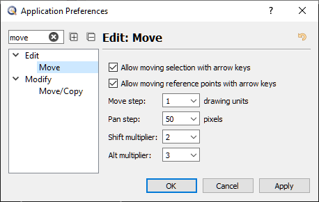

Dragging with the mouse doesn’t work well as in QCAD it is not possible to drag multiple objects unless they overlap. And anyway, as it is CAD drawing I need precise reference and end position so dragging alone do not seem feasible (unless I am missing something).
Moving with arrow keys is OK but still I don’t understand how to move precisely from a reference point to an end point. It is also not very convenient for long distances.

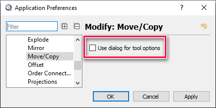

My question is about the number of clicks needed in the MV dialog. Is it possible to rethink the design? I really think that the radio buttons could be replaced by standard buttons (with keyboard shortcuts assigned). That would be already a big improvement.
Actually you are able to drag multiple objects, even without overlapping … :wink:
I agree. But, depending on where you click the selection the reference will jump to the closest “basic reference” like end, center etc etc..
It’s a different strategy. One arrow key stroke moves the selection a certain amount of units. How many units are used can be controlled by you within the Application Preferences.
Now you lost me! How will you simplify or improve this simple setup …
… or could it be that you never tried the “Non dialog” tool option? e_surprised
… I need a coffee!
Mind blown! I totally forgot about that setting. It seems no matter how long I poke around in the applications preferences I eventually forget about some of the settings in there. I like the no dialog box option. :smiley:

… or could it be that you never tried the “Non dialog” tool option? > e_surprised >
No, I didn’t know this option exists. I tried it and without the dialog, MV suppresses the original (“move” behavior). I wonder why the three options (move, copy, copy-multi) do not appear on top left toolbar as it is the case for the LG function for example. It would be an excellent solution to choose the behavior at the beginning of the MV process. It would mean less clicks most of the time.

Like pointed out … See Application Preferences

That is why it is included under Application Preferences.

Most tools under QCAD will list their options in the Option Toolbar, some use a dialog and some a dialog or the toolbar.
So you should always keep an eye on that rather important toolbar. :wink:
