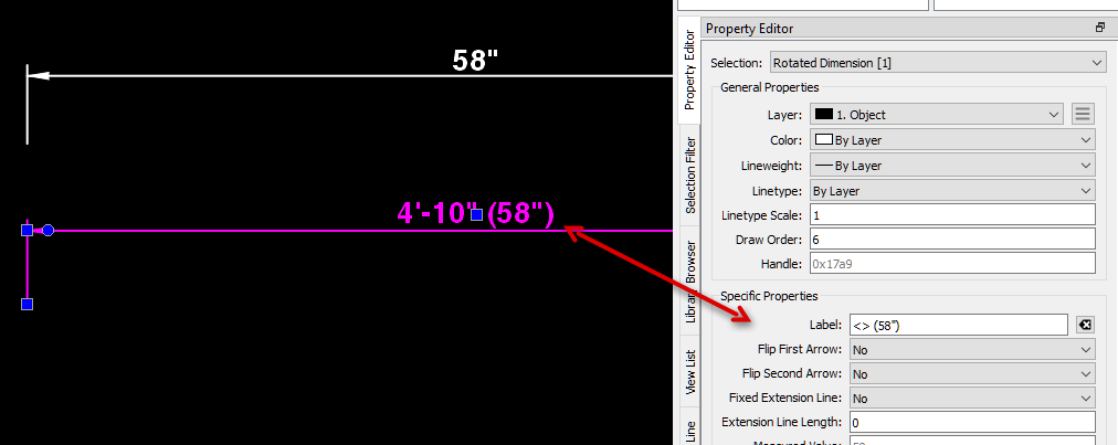

If you select a dim you are then able to manipulate the label within the Property Editor. If you type in 58" it will replace the measured value of 4’ 10". This text is then static what means it will not change in the case that you manipulate the dim.
If you like to combine a dynamic text with a static text then you can use <> which represents the actual measurement and a static text like (58") which stays static.
Not exactly what I wanted but it will work. Thank you!
