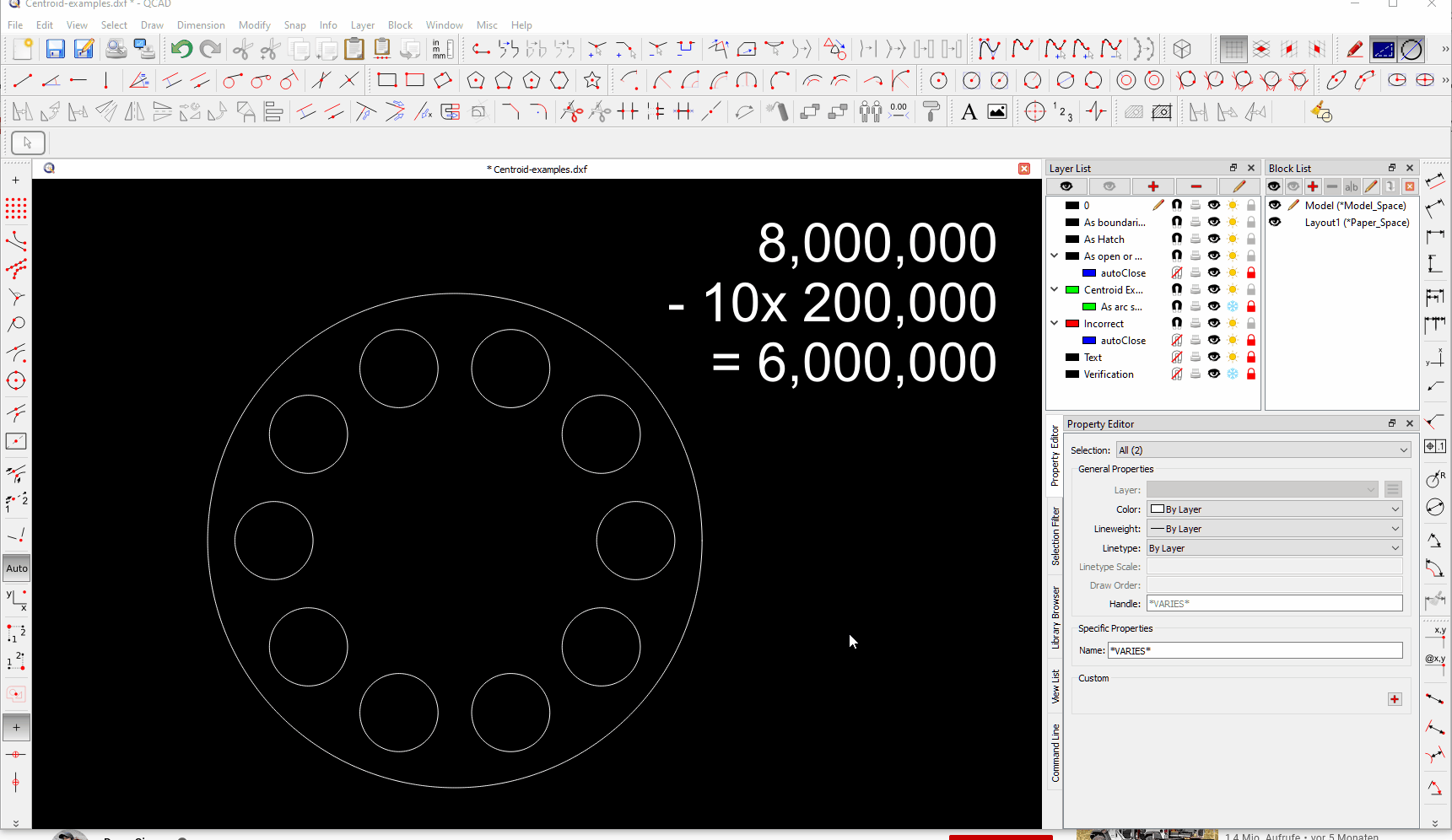

… I’m wondering why the calculation brings up a 6000000.0000000024 result. I used for testing purposes only whole Numbers for areas and the result should be a whole number of 6000000 - where is the .0000000024 coming from?
… I’m also wondering why the Annotation Text hight (based on the DIM Text hight value) is only used from the last saving status. Changes which should apply for new calculation are ignored until the dxf is saved again …
Info Area Centroid circle test.dxf (112 KB)
11+1 sucks but I like to have dialog warnings. Is like a hint with a fence post … However - 1 uppopping dialog would do it too but I guess that will be more difficult to code … !?
Husky, for the moment the tool does no fancy formatting, it uses full floating point.
The results displayed are those with 17 significant digits.
To begin with, your major circle has an area of 8000000.0000000030 squared units. :open_mouth:
One thing I am sure about. :laughing:
That is the floating point result of RRPi with both R & Pi in floating point. e_geek
For an area = 8000k the radius needs to be 1595.7691216057307117597842397375…
In the best case that is stored as 1595.769121605731. (Except it isn’t :unamused: )
The uncertainty or 1ULP of 8000k or 6000k is 9.313e-10, it can’t get any more certain/correct.
Meaning that the main circle area is within 4 ULPs.
The differential area is the sum of 11 floating point values.
There the result is within 3 ULPs, and considering things (Boundary poly of two arcs …) that is rather good. :stuck_out_tongue:
