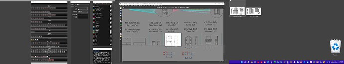

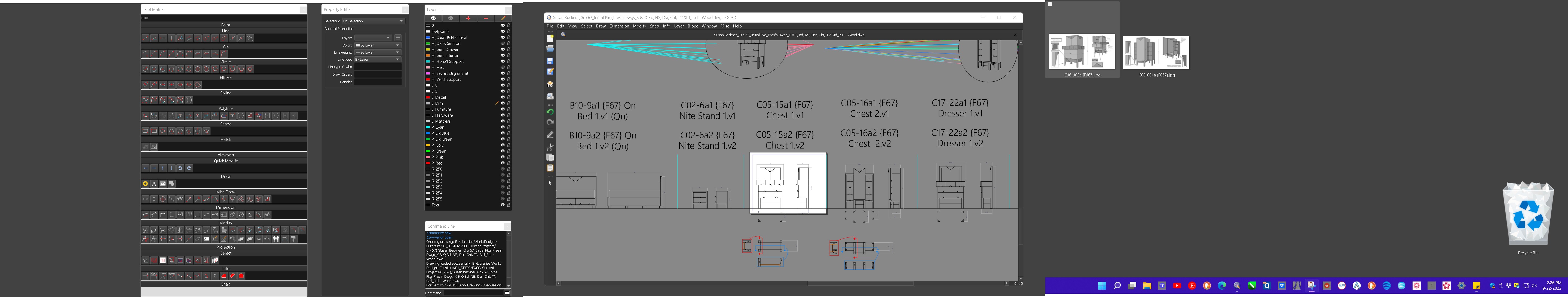

I have also attached a screenshot. As you can see, I have my file on ‘print preview’, but the options toolbar is not visibly obvious.
Thanks for the screenshot. Is your screen so wide or is that from a multi screen arrangement?
In any case, I suspect that the options toolbar might be floating about somewhere, perhaps even partially or entirely off the visible screen.
