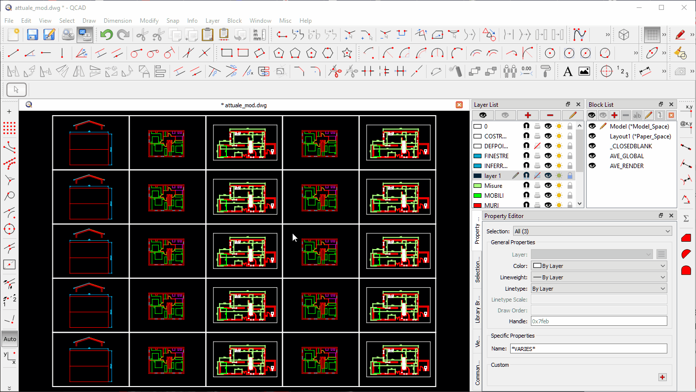

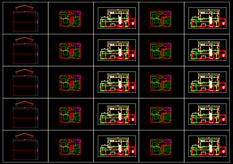

Allego un esempio di disegno diviso in 4 aree: ho bisogno di selezionare una singola area e stamparla. Grazie
attuale.dwg (31.2 KB)

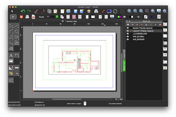

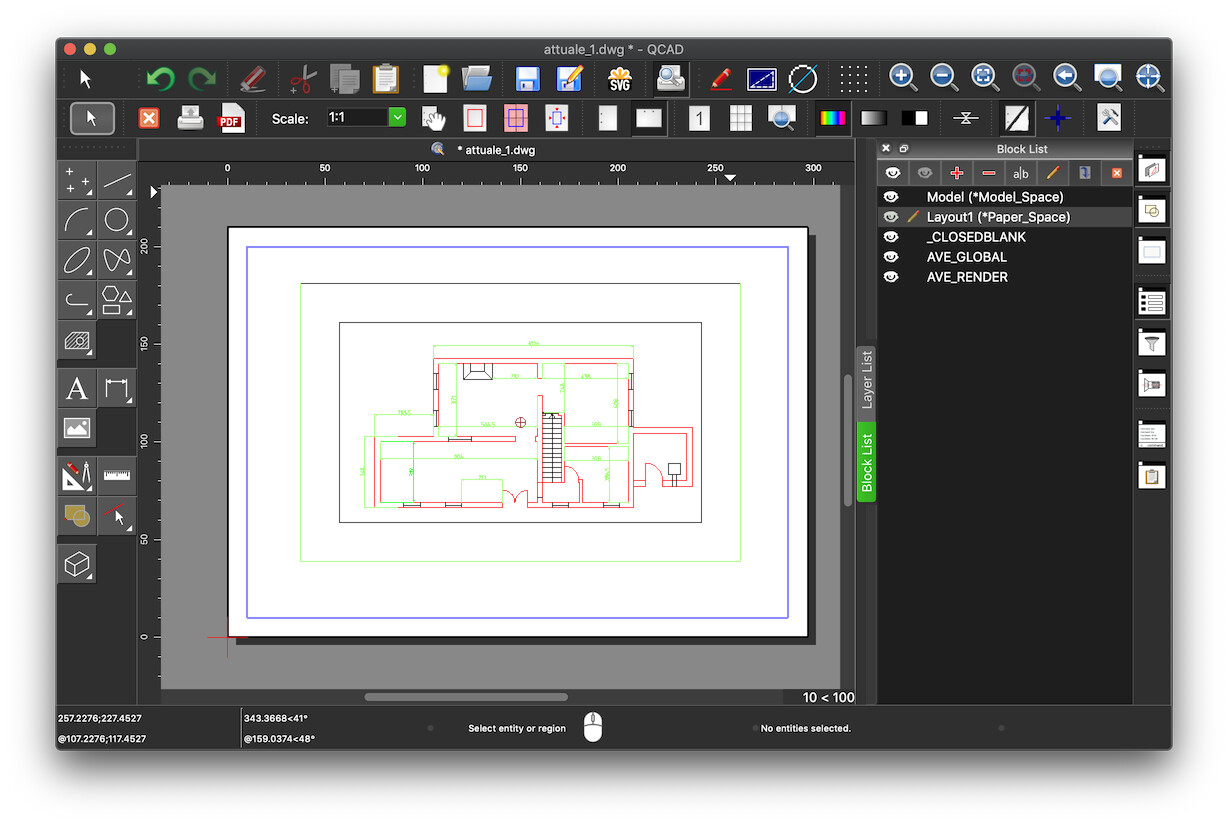

Consiglierei di creare 4 blocchi di layout, ognuno con una finestra di layout (viewport) dell’area appropriata:
Ecco un esempio per il primo blocco di layout. Puoi aggiungere altri blocchi di layout con le loro rispettive finestra di layout (viewport).

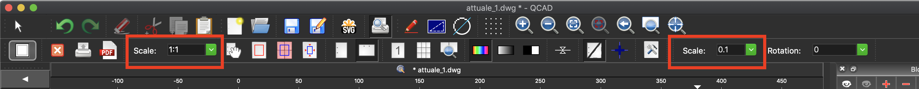

Si noti che si dovrebbe regolare la scala generale di stampa a 1 quando si lavora con le viewport (a sinistra nella barra degli strumenti delle opzioni). Puoi poi inserire la scala della finestra mentre la crei:

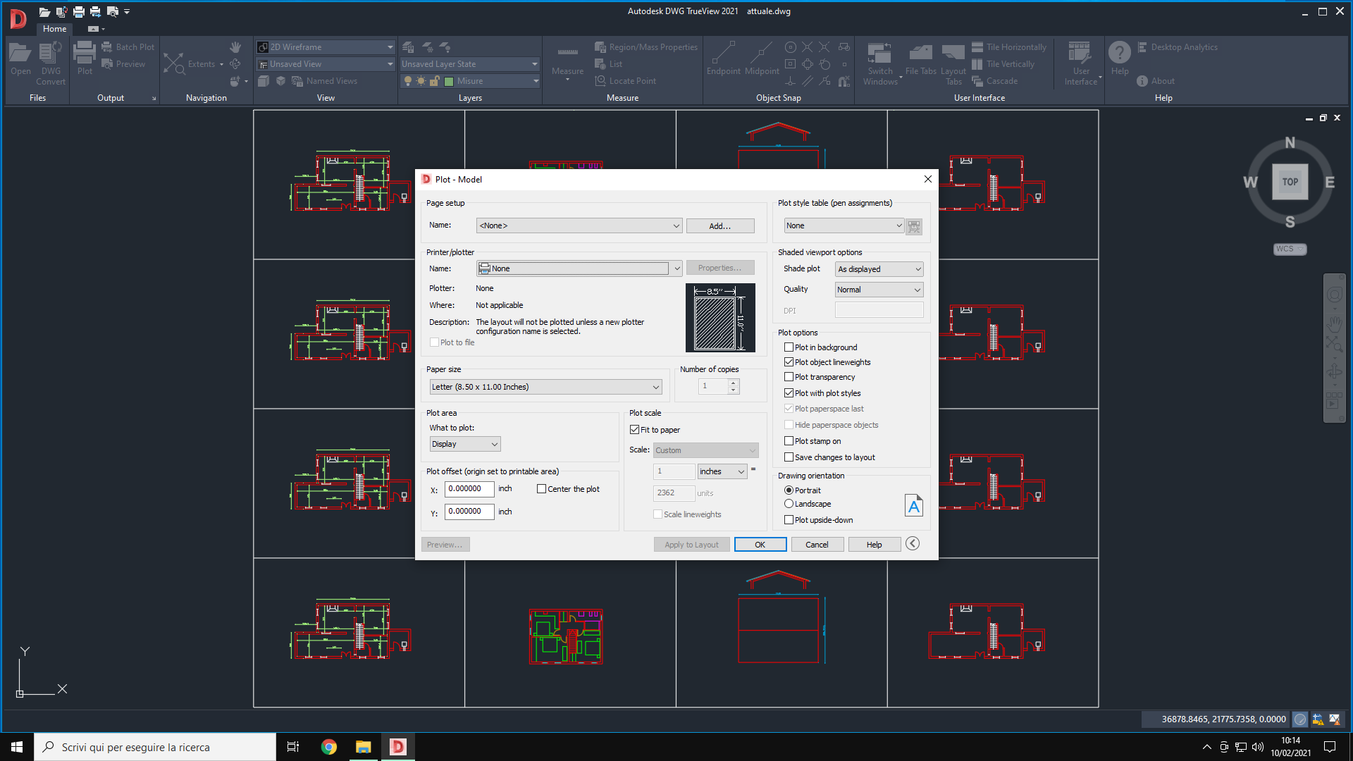

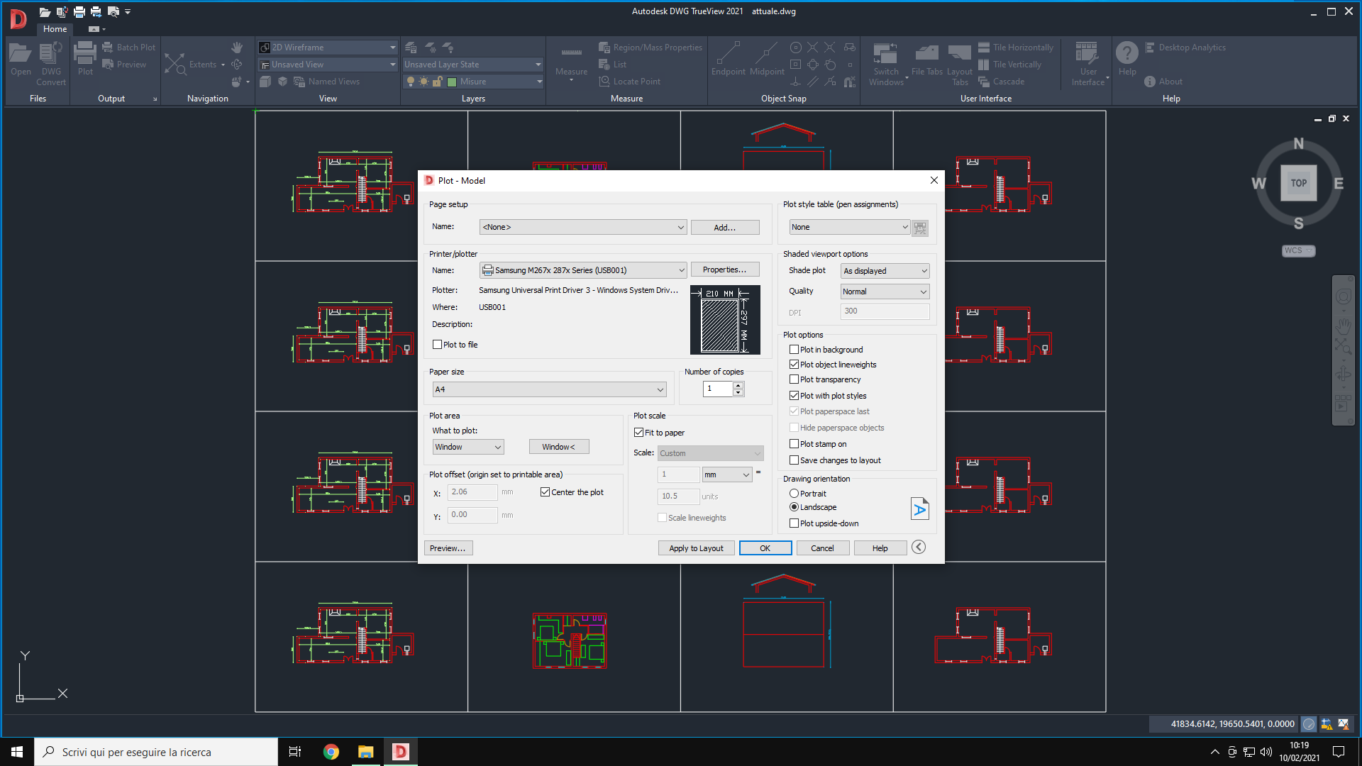

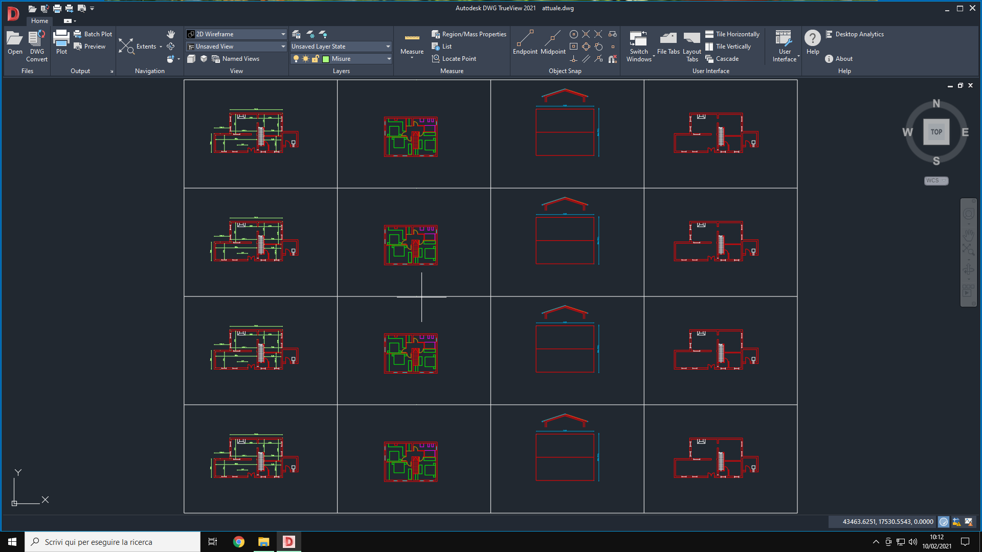

Thanks Husky. The method you mentioned might be fine, but it seems a bit complex to me. I attach screenshot of how to print with Autocad and / or DraftShigt. These examples run with Autodesk DWG TrueView (free software). 1) the file opens (Screenshot 12) - 2) Selecting the graph (Screenshot 13) - 3) Selecting the parameters (Screenshot 14). In this example the parameters have been selected: Printer / plotter / Paper size / Print area / Center the graph / Fit to paper / Drawing orientation and then OK. Printing is done on an A4 sheet. If you also select “Save layout changes” for subsequent drawings, simply select a different area (the Windows parameter is already selected) to print and then OK. Very quick and easy.
We move in a circle because you changed the specifications to compare the programs. On this way there will never be a clear solution!
But it accomplished all your requirements contrary to your solution!
Your mentioned the requirement that you have to print with a certain scale. Your “TrueView” setting “Fit to paper” will use a random uncontrolled scale for the user regarding to the print situation. That is something what can be done in QCAD too … Andrew suggested that already. :wink:

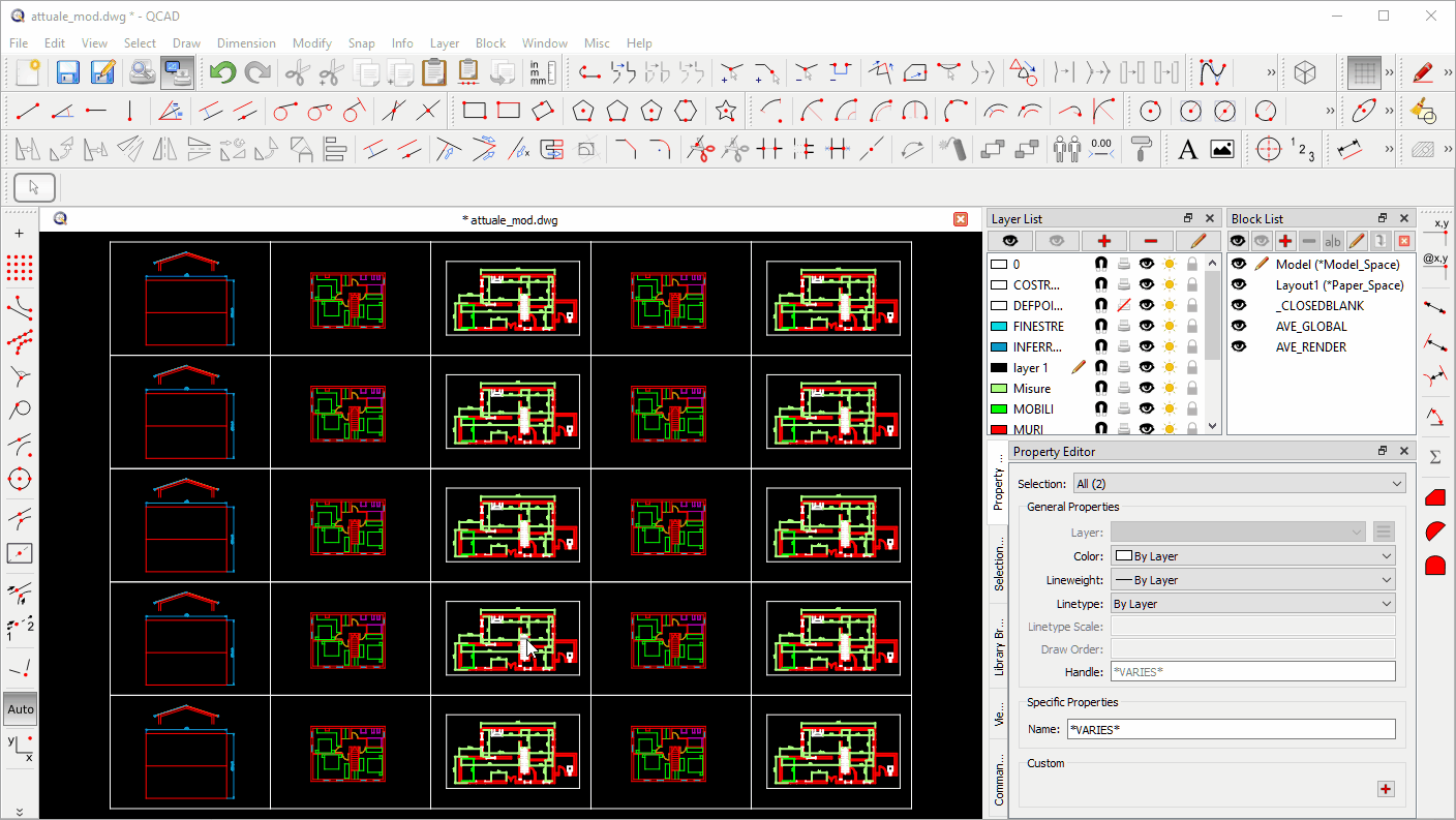

Husky, thank you. The method you indicated is really “quick and easy”, but it’s not accurate if you have to print the whole window. This is due to the fact that it is not possible to select exactly the entire window (which I always delimit in the standard A4 or 3/2/1/0 format) as the edges of the window are not “hoocked”. And this means that the various selections are never the same and in the print sheet (A4 / 3/2/1/0) the elements drawn in turn are never exactly proportioned to the printouts of other windows. If it were possible to “hook” the boundaries of a window it would be a very good solution.

If your delimited rectangle is a polyline then you can use it for the selection. That makes sure that you cover always the same window area, the “Print current view” has then the same size and the same scale. That makes your prints exactly proportioned to the printouts of other windows.
Note: In my sample drawing the delimited rectangles are on their own layer with a disabled “Plottable” option.
