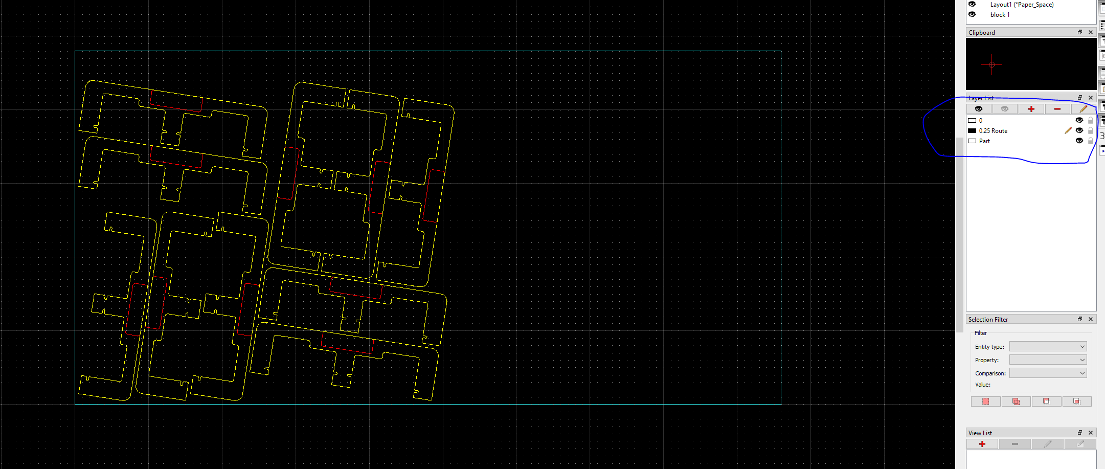

I have parts that will have primary cutouts (full routes) as well as partial routes (for dado cuts, ect). I don’t plan on doing the tool pathing in QCAD, just the nesting and some polyline creation from broken lines, ect. Right now I’m separating the different route types to different layers and I’d ideally like to keep it that way as that is the ideal input method for the software that I will use to do the tool pathing. What I’m trying to figure out is if there is a way to group (or block) the different layers so that they don’t get treated like separate parts and they stay together through the nesting process and components stay on the appropriate layers.

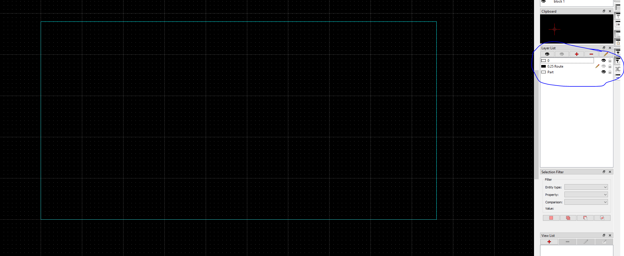

I’ve tried combining them in a block and then nesting the block but that has produced some weird results. For one thing it’s nesting everything at an angle for some reason even though doing the same nesting settings on the un-blocked parts produces a nest that is parallel to the sheet edges. I’m doing 4 rotations. The second issue is that even though the component layers of each parts are staying together as I want them to the way the components are distributed on the layers doesn’t make any sense. For instance on an item that has a full route and a partial route, if I hide the full route layer I can only see the partial route layers lines (expected) but then hiding the partial route layer hides both the lines from the full route and the partial route.

I agree and I don;t think that is expected behavior! I think that is a bug …
FYI: Normally you can nest parts like this one no matter on what layer they are designed on or if they are built out of blocks, polylines or even just lines and arcs etc. It will be nested like the original selection. In this case the red shape taches the yellowy shape and for some reason this will break the nesting functionality. Detach the shapes and it will work. I recommend to file a bugreport below: Flyspray::QCAD Bugtracker: Tasklist

IMHO:
Cyan is on Layer 0
Yellow is on Layer ‘Part’
Red is on Layer ‘0.25 Route’
Block References are also placed on Layer ‘0.25 Route’
With the application preference Showing Freeze:
Hiding or freezing Layer ‘Part’ acts on yellow.
Hiding Layer ‘0.25 Route’ acts only on red.
Freezing Layer ‘0.25 Route’ acts on Blocks, both yellow and red.
Without that preference one can opt if hiding means freezing.
For blocks with multiple contours inside, QCAD computes a hull prior to nesting. For such a hull, the automatic alignment does not work. Please switch off Edit > Application Preferences > CAM > Nesting > Align part angles to axis to avoid this.
Without using blocks, the detection of the red contour as island of the yellow contour fails. The red contour is not completely inside the yellow contour because of shared edge. These contours are considered to be intersecting and treated separately. This will likely be improved for the next version for this particular use case.
